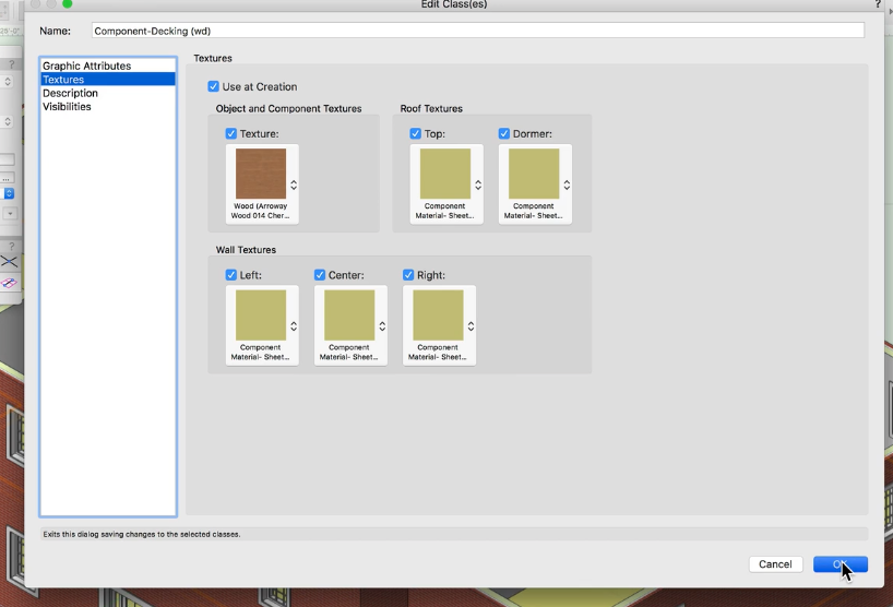

This is not the first time I've had issues with discrepancies when following along with tutorials, but I cannot figure this one out. I'm on the "Cutting holes in the slabs" portion of the small residential model section, of the intermediate concepts course. Around the 10:40 mark of the video, the instructor changes the textures of the floor assembly but I'm not able to recreate it. There are a couple differences between 2019 & 2022 workspaces that have been problems in previous tutorials and learning paths, so I'm hoping y'all can assist me so I can solve my own problems in the future.
In 2019, the plywood decking is in the component-decking class, but in 2022 its in the component-structure class (component-decking doesn't exist). Not sure if it matters, but 2022 also has a materials column that doesn't exist in 2019 workspace.
The instructor then goes on to edit the class' texture, which changes the appearance of the plywood to that of a hardwood. Whenever I attempt the same, (remember, mine is only in the component-structure not component-decking) the appearance does not change. It's still the same OSB appearance. Is there something that has changed between 2019 & 2022, possibly related to the materials that would prevent the change from happening?
