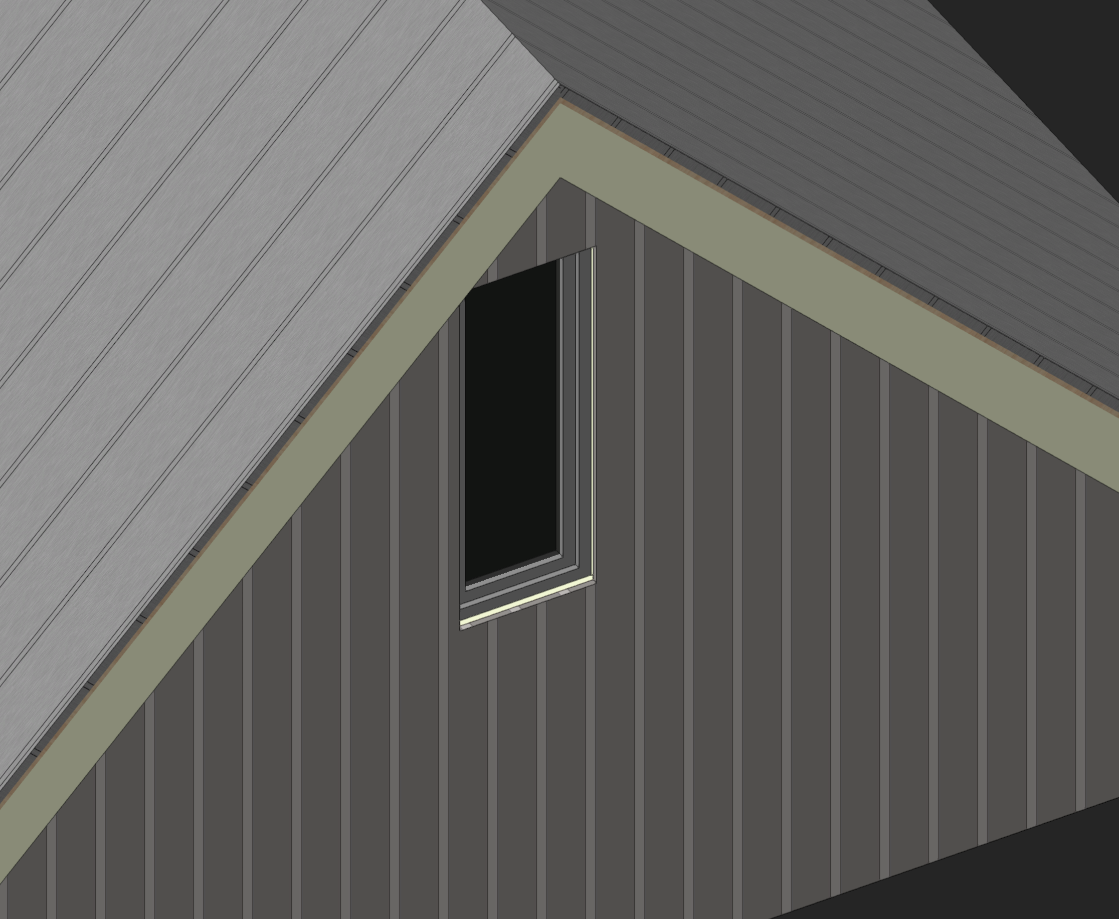

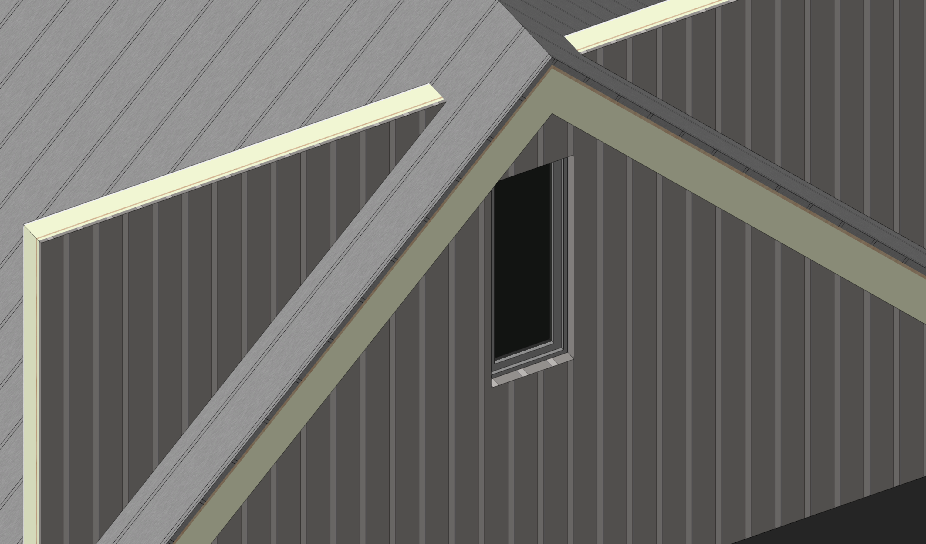

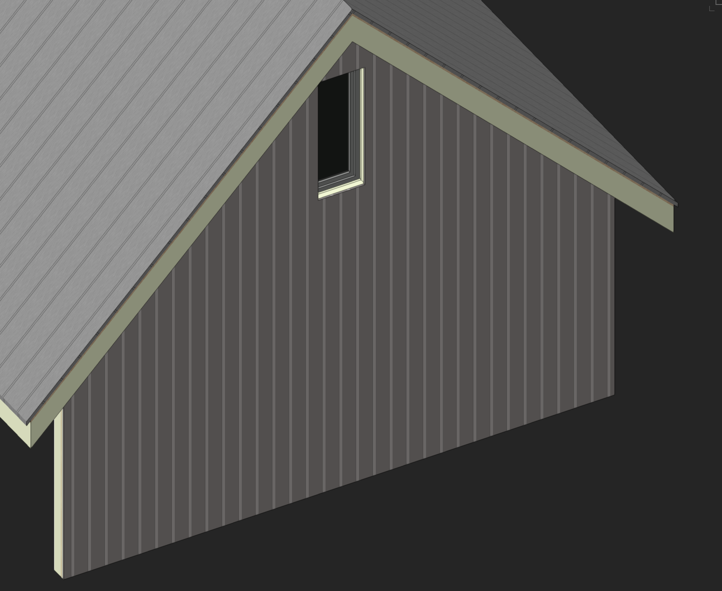

Thanks a lot @Tom W. Indeed the bottom of my wall is above the bottom of the roof. However if I lower it (attached) , same results , no wall closures Wondering a reason tying the wall closure to where the bottom of the wall sits? For now I guess I will be content with using wall edit @Matt Panzer should this be entered as a bug to be fixed? -

Hi @Tom W. Yes wall closure settings is present for the insert. Wrappings don't show in both Top/Plan & 3D. When I delete wall peaks , , wall closures come back Edit wall tool works (great!) and wall closures do show. Excuse my ignorance , what is the bottom of the roof? how to set the bottom of the wall to be above/below the bottom of the roof? Thanks for your help Happy that there is a way around it (ie edit wall tool) -
Any one has experienced this? I attached 2 screenshots of the wall before and after applying fit walls to objects (roof in this case) basically all the wrappings ( eg. at the window sill) disappear for some reason. I tried 2 options for control : Using wall closure and using insert wall closure override. Same results . Thanks for your help

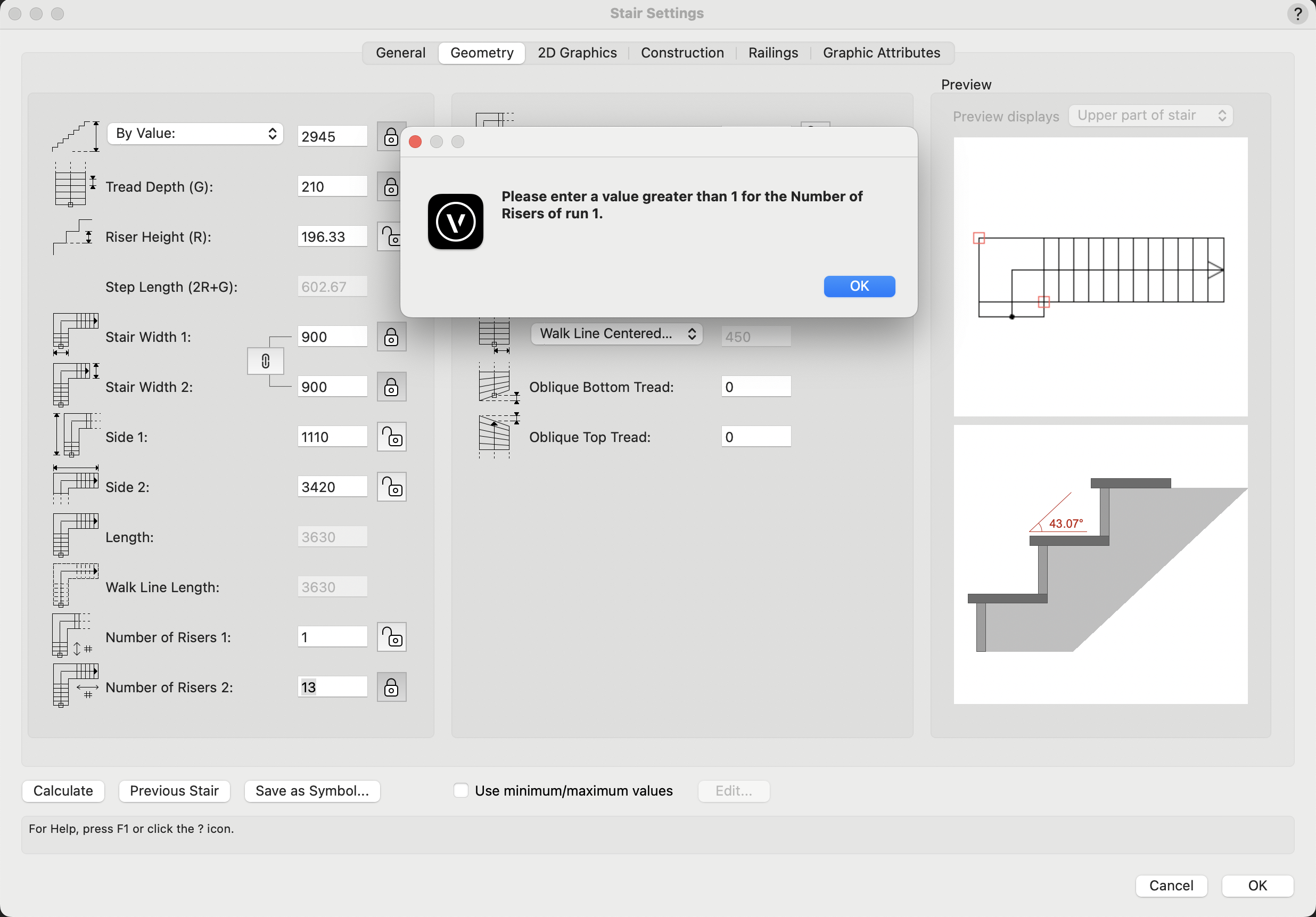

Thanks @Jonathan Pickup The stair setting won't allow me to enter "1" as value ( number of risers 1 ). I get an error message different from the one you shared . see below. No options offered to recalculate the number or risers . Dis you use "standard" stair tool? Can you please share a screen shot of the stair settings window ? I looked at the other two tools you suggested , simple stair and custom stair. I was able to get the result I wanted but I would rather use the "standard" stair tool Thx -

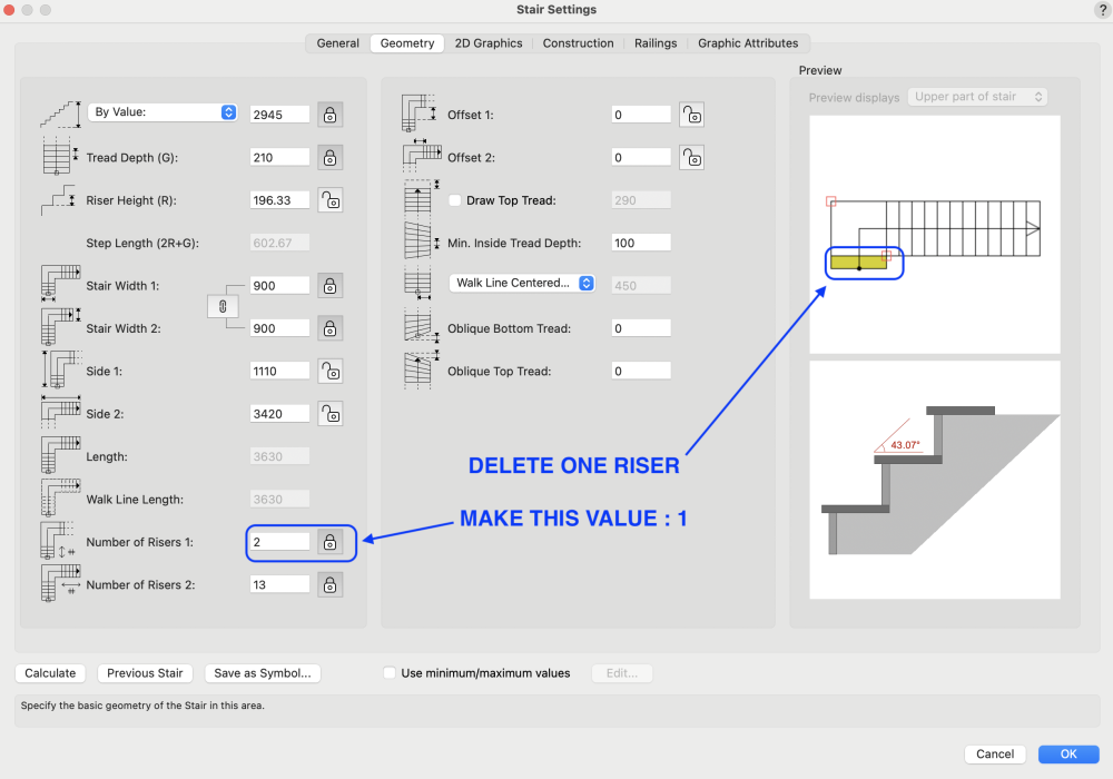

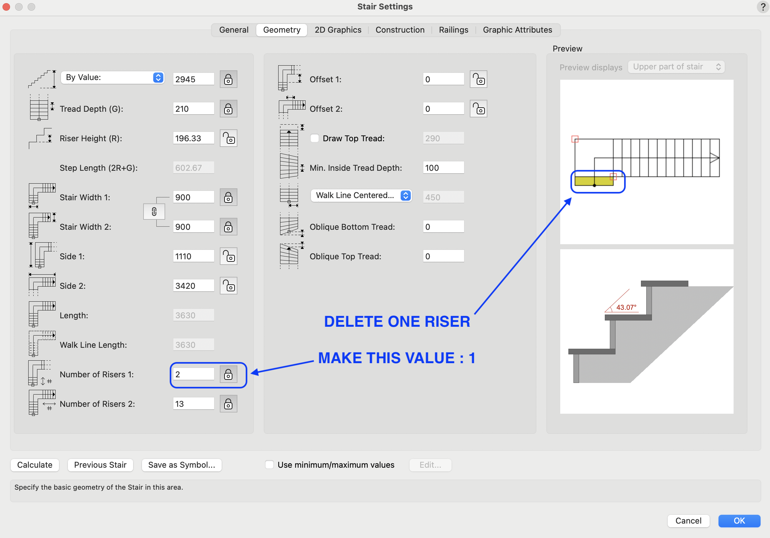

Hello I am trying to set up an L-Shaped stair with one riser only at the bottom but the stair tool doesn't seem to allow it ! Any idea how to achieve this? thx for helping
