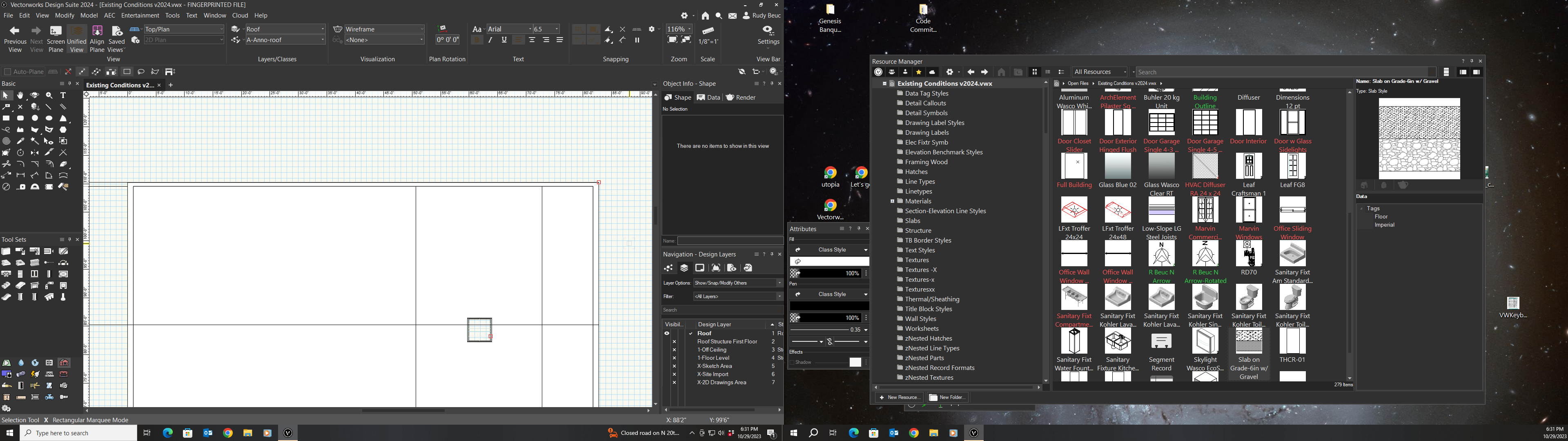

I'm having a problem. I have a site model. It has modifiers attached to it defining roads, sidewalks, new contours, ect... When I go and try to change the class it sits on, the material, or texture, defining the surface gets changed. Why is this happening? There is no texture or material assigned to that class. Please see attached video. Thanks, Rudy Beuc 2021-09-30 23-11-24.mp4

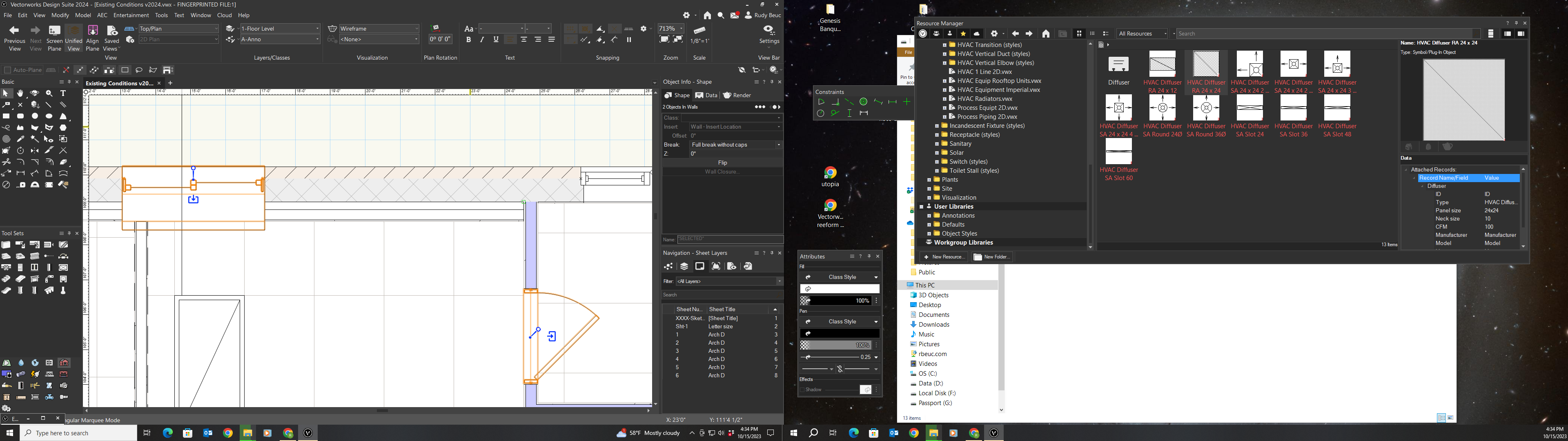

I'm in the process of migrating from Revit. Currently I'm trying to figure out class naming standards and so forth. I've found the standards sub folder within the VectorWorks program folders and libraries using the Windows file browser. However, when I go to my resource browser and look for the standards folder there, no luck. ?? using the windows file browser I've opened up the ClassNameStds.sta folder and am able to peruse it's contents. I think I want to create another column for my own standard. Or maybe copy this file and just change the lineweights and colors. What exactly is an *.STA file, how is a new one made, and how does it get connected with the "Standard Naming" command? What's going on under the hood? Thanks, Rudy Beuc

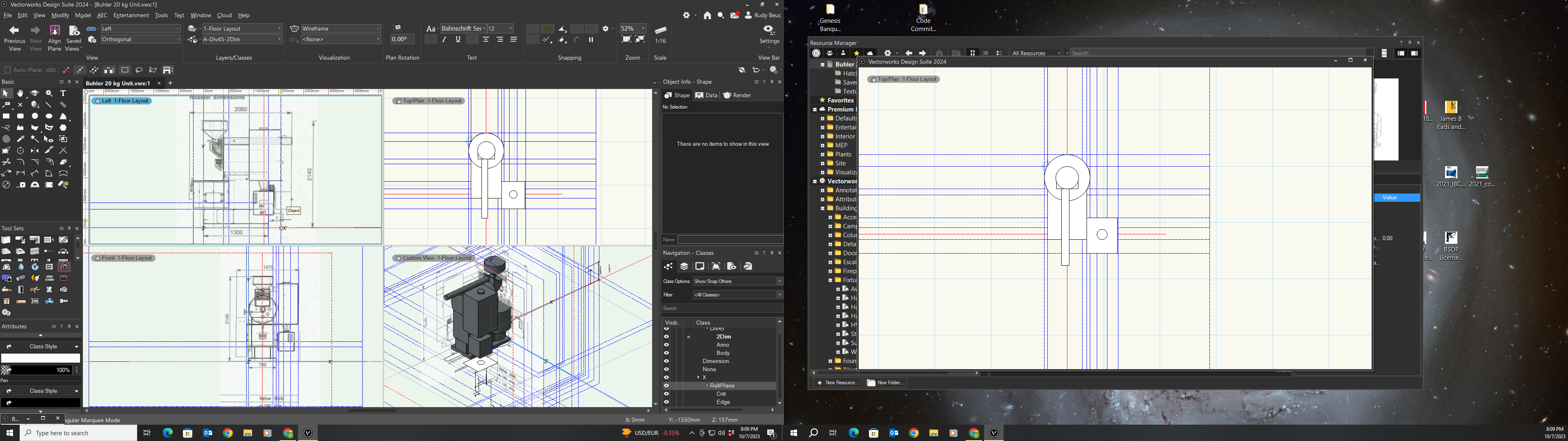

So yes, I have a lot of fonts installed on my computer. I find the drop down menu scrolling behavior troublesome. I can't access any of my font styles beyond those with C as the first letter. I have dual screens. Attached are videos and screenshots which I hope communicate my problem adequately. Is there some setting on my end that I can adjust to resolve this? Thanks, Rudy Beuc VW Main Screen.mp4 MS Word Font Dialogue.mp4 VW Secondary Screen.mp4
