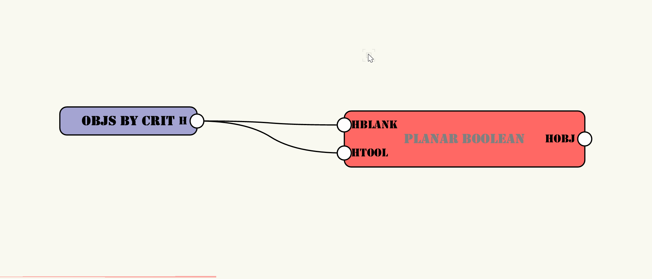

Is there a way to export a 3d saved view to multiple format: 3dm, step, obj, fbx in one go ? A bit like the publish command with pdf and dwg... I looked at marionette but I don't see any export functions... Any ideas ?

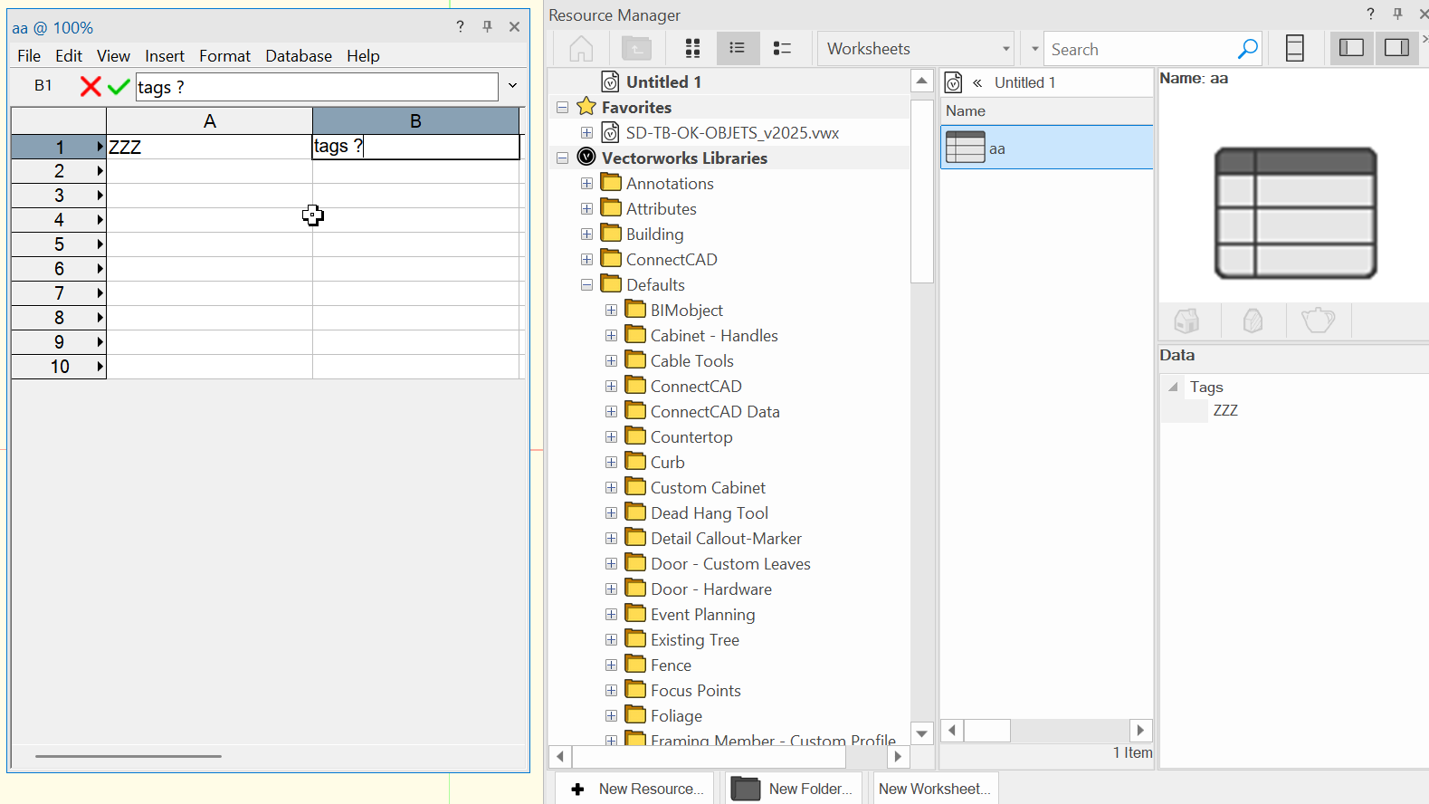

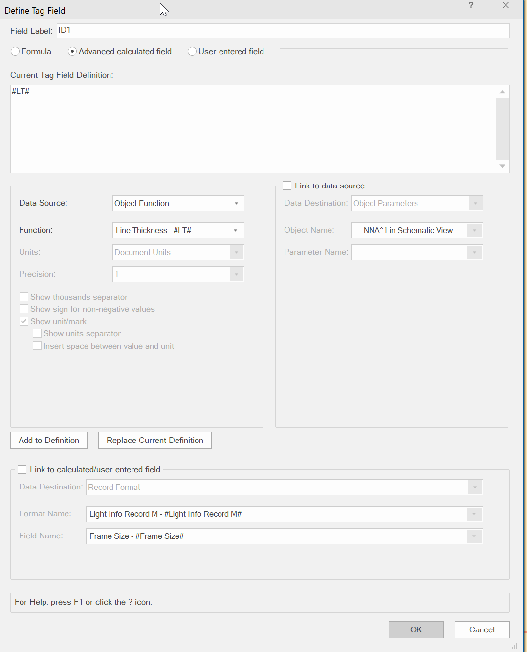

Ok, thanks. Data tags is not like a view, where I can link a viewport, and navigate to it in a PDF, or I am mistaking ?

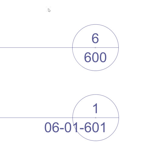

The project I am working on is configured with long sheet number: 06-01-001 Can I show only the last 3 digits in the callouts ? I tried #Detail Callout2#.(LEFT#SheetNumber#,3) with no luck.

Data tag info of worksheet in a cell of that worksheet
setdesigner replied to setdesigner's question in Troubleshooting

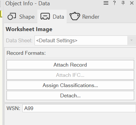

Thanks Pat, I found the post. What I wish to achieve is modify multiple worksheets at the same time, without opening them. So I tought about attaching a record to the worksheet image so I can select them and change the record to change the value in the worksheet. -

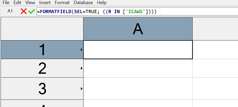

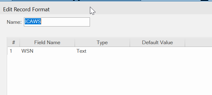

Ok, I realise I cannot get the library tags in the worksheet. What about adding a record format to the worksheet image. I am tryning this and recalculate when the worksheet image is selected but it does not report the value, any clues ? =FORMATFIELD(SEL=TRUE; ((R IN ['ICAWS']))) or =FORMATFIELD(SEL=TRUE; 'ICAWS'.'WSN') 2025-03-11.vwx
