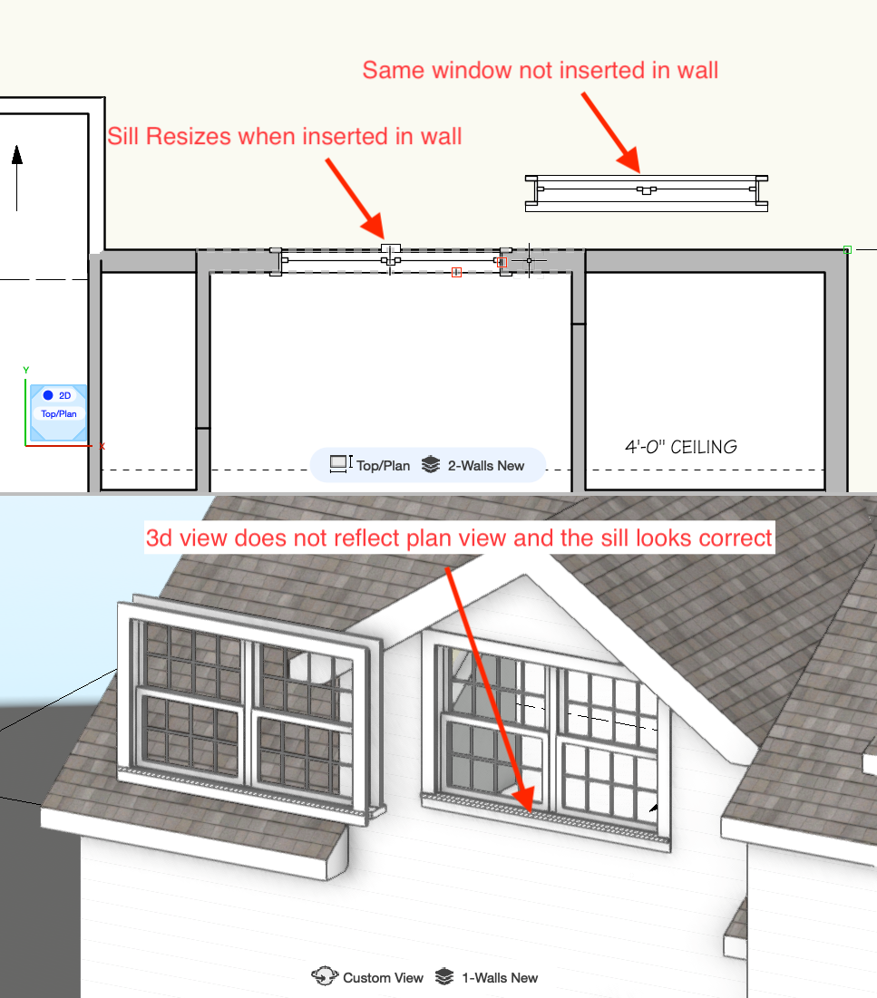

Hey Everyone, Has anyone else notice an issue where the sill of a window resizes itself when inserted into a wall? it seems to be happening when I'm using custom windows. It doesn't happen everytime but I haven't been able to troubleshoot a reason why it might be doing this. I've also noticed this happening in 2025 so I don't think it's specific to 2026. It's probably user error and I'm not sure if there is a setting I might be missing. I've attached a screenshot showing the issue. Thank you, Derek

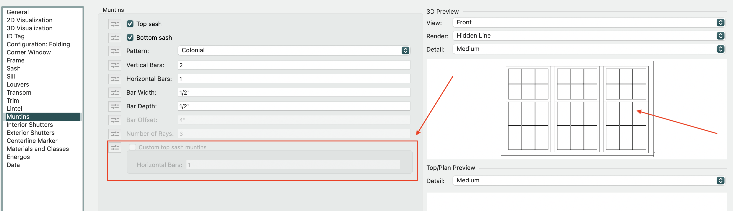

Thank you again! So it only works for single cottage style window and not for multiple cottage style windows. Muntins need to be window specific in custom window configurations. I feel like they started the custom window tool but have put it on the back burner. In the meantime i'll just continue to create 1 cased opening for the wall cut, 3 individual cottage style windows, and 2 mullions grouped together and carefully placed within my cased opening. I do the same thing when it comes to a triple window that has 1 center picture window and 2 flanking operable windows that need different muntins. I also use this method for front entry doors with sidelights and transoms. Is this how everyone else is doing it? -

Obviously, I still need to experiment more, but I’m switching back and forth between dual boots so I can run 2025 and 2026 simultaneously. I’m curious whether copying a window created in 2025 and pasting it into 2026 or creating a new one from scratch in 2026 will make any difference. I’m always surprised when certain options are grayed out with no clear way to activate them. (Looking at you, “custom top sash muntins”!) -
