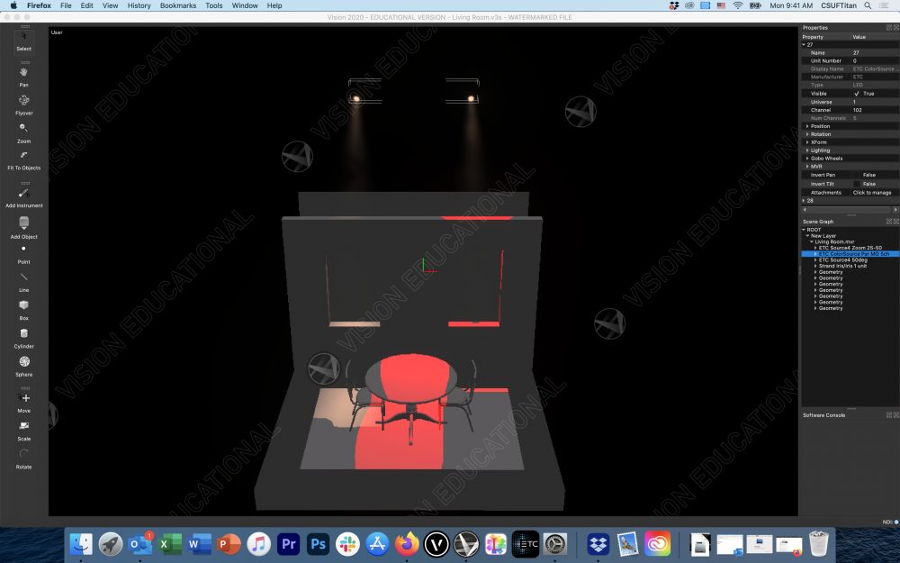

Thanks for continuing to look at this @bbudzon! Yes, those images look the same as the Vision files when I look at them on my PC. Not sure why they render differently on my Mac(s). Sometimes the beam is red as well. When the beam is red, though, it doesn't interact with surfaces. (see attached photo) There are so many different weird things happening that I haven't documented them all. You say the file isn't loading textures properly. Is there anyway to help Vision locate the textures? Both the Vision file and textures folder are on my computer's desktop so I'm not sure why Vision is having trouble finding them. I am using a 16" MacBook Pro (2.6 GHz 6-Core Intel Core i7, 16 GB 2667 MHz DDR4, Intel UHD Graphics 630). I also tried it on a 13" Macbook and had the same issues. (1.4Ghz quad-core Intel I5 128 MB DRAM Intel Iris Plus Graphics 645) Thanks! Scott
Thanks for your quick response! In answer to your questions: Two different files have the same issues so I don't think it is a file issue. I did transfer the textures folder. Changing Candela / Color Temperature / Color Wheels / Gobos has no effect. Changing "force emissive" to "true" turns off the light. I turned off shadows and got a slightly different kind of strangeness but still very strange and unusable. The weird shadows are not fixed by changing the shadow quality or refocusing the light. They persist even when render shadows is turned off. I transferred the files using a thumb drive and had the same issues so I do not think that DropBox is the culprit. I'm attaching the files and textures to this message. I am using a 16" MacBook Pro (2.6 GHz 6-Core Intel Core i7, 16 GB 2667 MHz DDR4, Intel UHD Graphics 630). Thanks again! Scott Archive.zip
I created Vision files on my desktop PC at home that are very buggy when I open them on my MacBook at work. When I select a light, it either turns on with a red beam or doesn't turn on at all. Many of the beams also seem to pass through objects or have strange shadows in the middle of the beam. This was a problem my students had frequently last semester but which I could never replicate. Now it has happened to me and I'm not sure how to fix it. I've tried dropping all of the settings to low quality and it still happens. Maybe it has something to do with screen resolution? My monitor is 3072 x 1920, which is not a resolution option in Vision. Or it could be PC to Mac conversion? Or is it from transferring files via DropBox? I've moved the file from DropBox to my desktop and still have the same issue. Has anyone else experienced (and solved) this issue?
