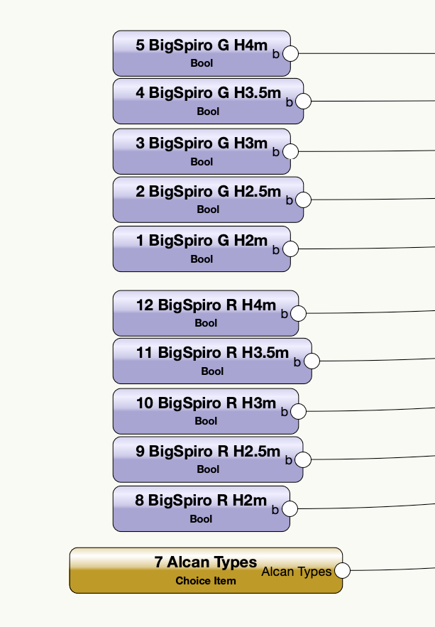

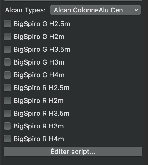

  6. Hello Thanks for this addition ah... it's just done with a number what I didn't understand is that the number is not visible!!! Thank you
  7. how waou How did you do it? This way is already good! I wonder if it's possible to have groups like delimited containers but ... separated this way is fine thanks

  9. Thanks for your answers yes of course putting a number is a simple and effective solution! I was wondering if there is a solution to do it in a hidden way? I remember another parametric symbol where I tried to place a “_” before the name of the parameter entry. But it doesn't work! Another question .... is it possible to make groups? In this case, it's a matter of placing symbols on the left or right. Would it be possible to make one group for right- and another for left- heights? Thanke in advance
  10. Hello everyone, here's a new question.... I'd like to be able to make groups or, and, above all, sort the options according to my choices. Currently, alphabetical order is preferred... grrr how do I sort the item info palette? Is there a trick? Thanks

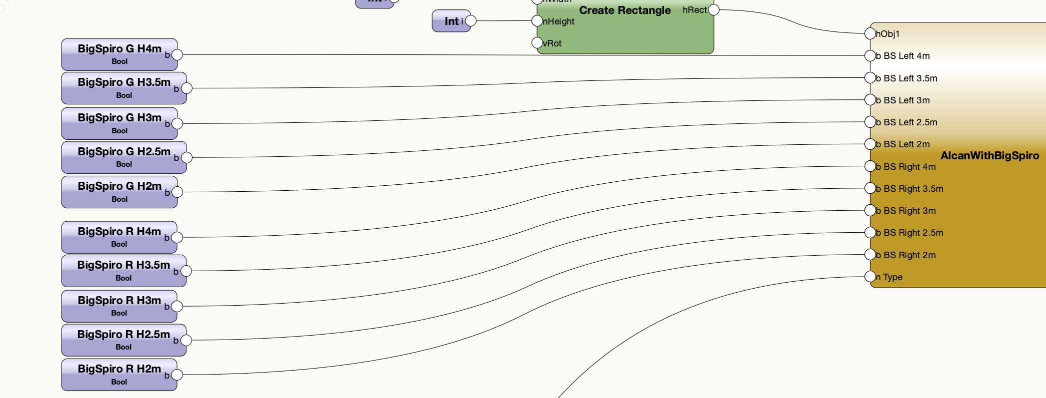

  11. Hello, Why a working script stops working after an envelope has been made. 🤔 when the script is run, extrusion is performed but once the envelope is created, there is no longer any 3D visibility profil Connection 90deg 1879_v2forum.vwx
