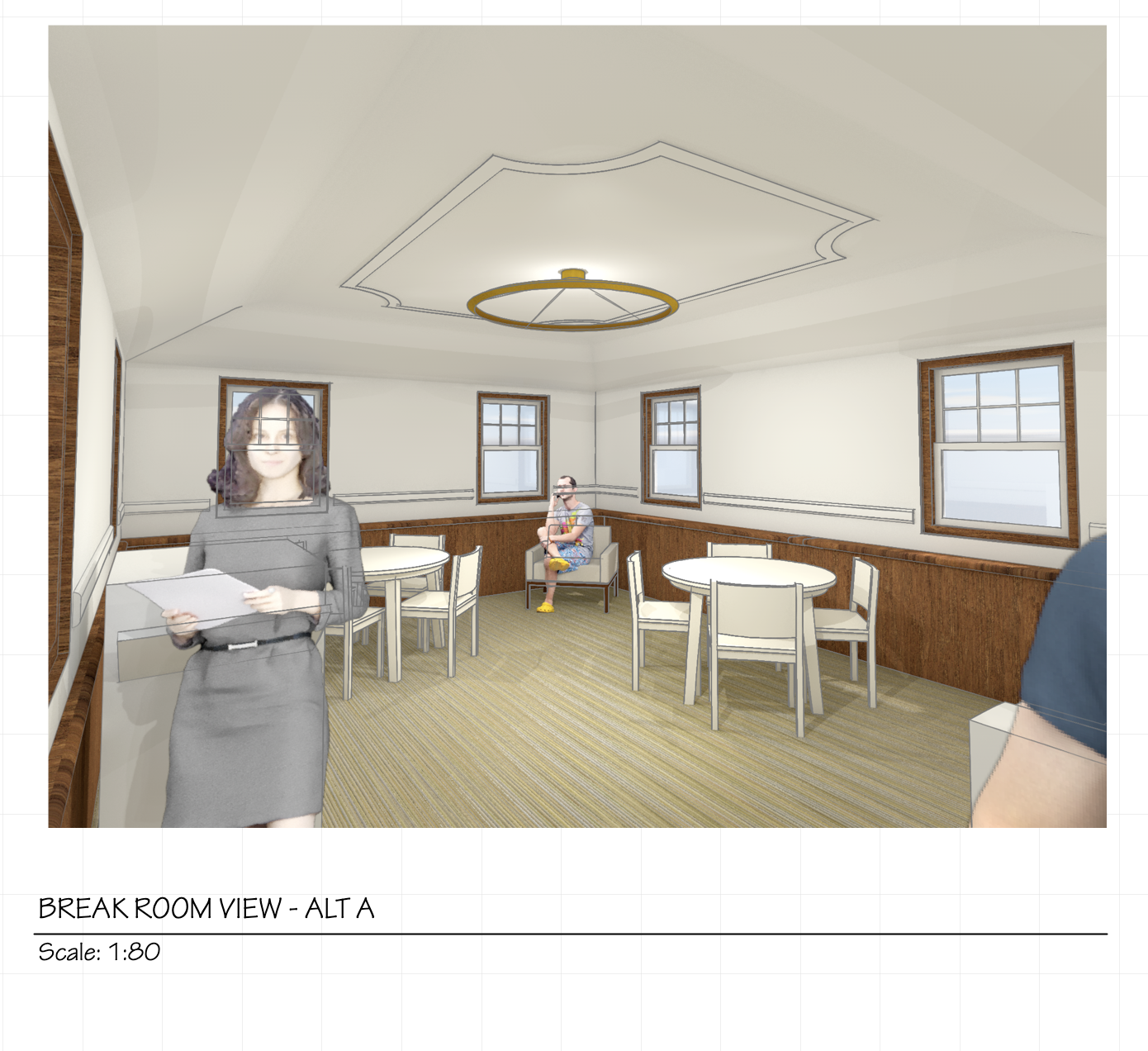

I have a different issue with Artistic Edges. When I combine VW built-in Turbo-squid entourage (in this case Gwen Standing Holding Paper Photo Front Right IP) with artistic edges set to on in the viewport I get this disturbing result - the entourage are transparent to the edges. I have tried editing the entourage transparency - can be done but is deep in the controls for the texture... but it doesn't help. I also tried recreating the mask component of the image and re-uploading into the texture as a .png with a transparent (not white) masked area... tried setting "alpha channels" different ways... nothing works... so I need to choose between having entourage or using the artistic edge option... anyone fixed this? -
