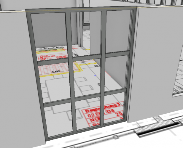

Thanks for your reply. Good to know that one is not alone. I am using 2020 Architecture. Even if i removed the Plug in/Symbol, the problem is still there. I have toplan a whole new window from scratch to remove the problem. -
Ok. I basically dont have a clue why my drawing is doing this. My windows are mirroring in a Section viewport (see Pic. 1), BUT they dont in 3D Perspective or in elevation sketch mode (see Pic. 2). I dont understand why. It must be a setting problem cause when i insert a different window from another floor in the same place. It doesnt do it. Any ideas, what setting issue it could be? I unfortunately have a lot of these windows as Plugs Ins in my plan. Thank you so much.
By the way, this idea didn't change anything unfortunately. But thank you.

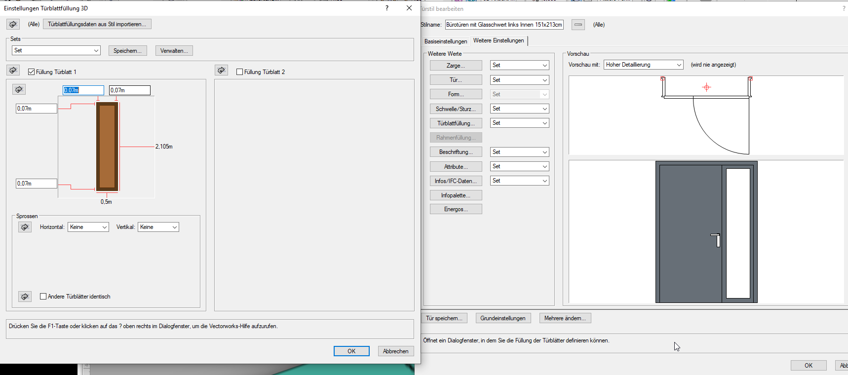

ah ok. Good to know. Thank you. Still, it seems then, that the european version is much more limited. Which i hadn't expected. I even have to create a separate symbol Plug of rounded door handle because it isn't standard in the list of options for doors and now we're talking about having different options for colour and material between a door leaf and the Sidelight!!......this is all universal stuff. Ah well, thanks for clearing this up for me.

Thank you everyone for your help. I will pursue this at the european branch. But seriously, I wonder why there are differences like that between the american and the european version to begin with. It seems unnecessary to me.

Thank you for your answer. Unfortunately it doesnt allow me to chose a sepatate Class for the doorleaf Fill.(See below). I am adapting a Door Symbol (Plug In) from the vectorworks Resource manager.

Hallo everyone. I would appreciate some help. When it comes to a Door with a Sidelight, I can not seem to change the colour/material of the doorleaf so that it differs to the door frame. For example here below, i wish to have a white doorleaf however in the list of attributes available, the doorleaf attrubute incorporates the Sidelight as well. So that i end up with all white or all gray. The door frame easy to change. Have i done something wrong here. How else can i draw up a door with Sidelight so that the elements remain separate when it comes to attributes.
