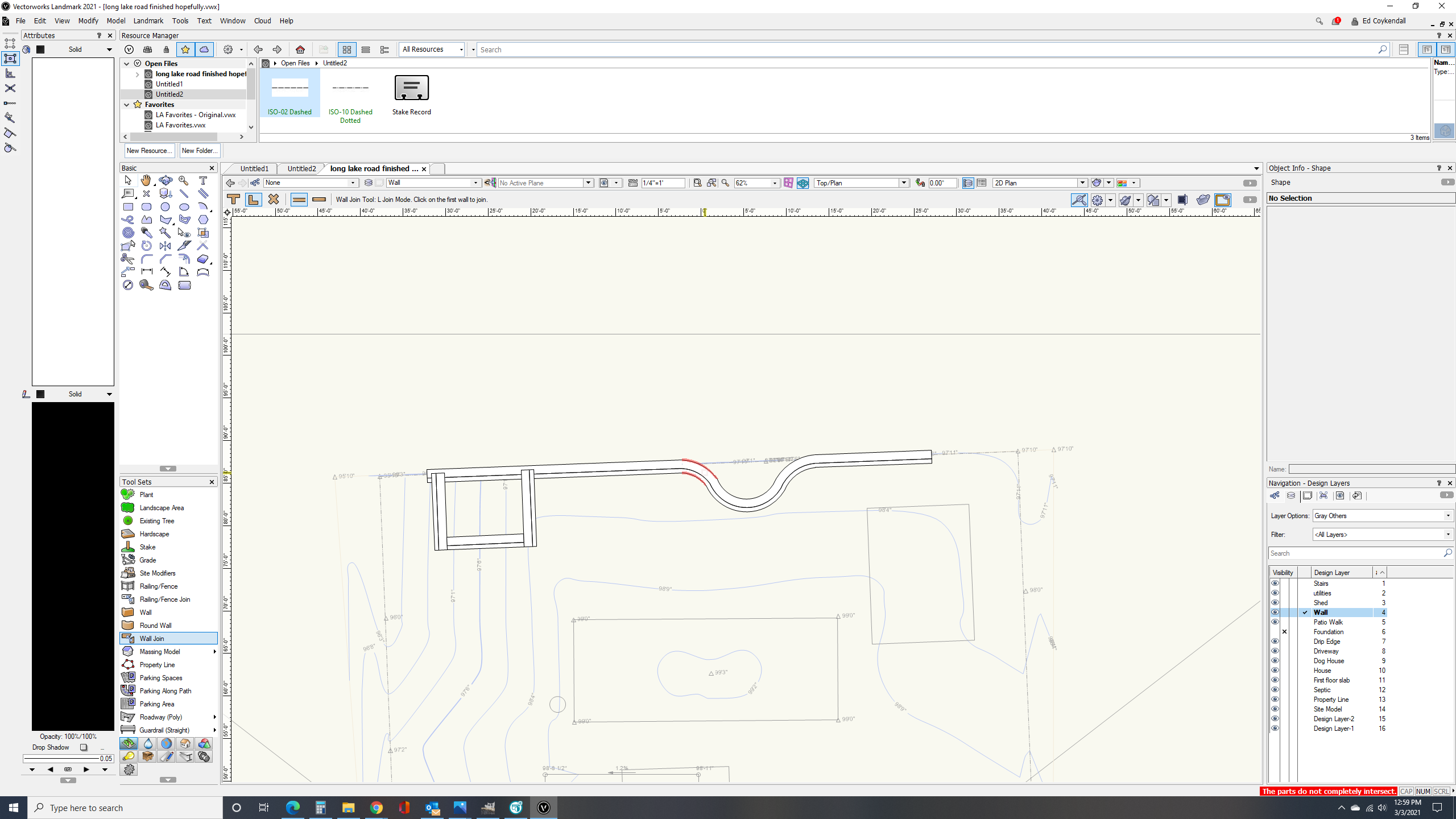

  1. Here is the file.  This is a practice project to get me up to speed on basic 3d so a bunch of components are missing but the wall is the sticking point.  Wall modifier says walls are not connected.  I went through the classes, layers, elevations and think I have them all the same.  I did these with the fillet tool but it left really small pieces of straight wall.  I will do another free from and post that as well.

  4. Yea I've been drawing from poly then convert to walls.  I've done it in any way I can think of.  The problem is that when you go to do the site modifier it says walls are not connected.  I've also zoomed in on the place where the connection is broken but can't get the vertices to show up to reconnect so I'm guessing that functionality is not there.    Its particular to curved walls getting segmented when converting from poly lines into walls then they get disconnected.  Like I said in a previous post there is very little out there on the subject.  I'm missing something here or is there a glitch in the VW universe.
  5. I repeatedly have a problem connecting walls via Wall Connect Tool.  Here I have a series of walls combo of straight and curved.  They were created with create objects from shapes from a poly line.  I combine connected before I did create objects.  I try to join the straight walls with the first curved walls and get the error that the walls do not completely connect or nothing just no connection.  If I skip the first curve and go to the second and hit join VW creates a wall with a 90 tangent.  I created a wall with a core component.  The straight walls work fine.  Do curved walls not connect?  Am I over thinking this?  Do I just go with it?133260776_Screenshot(29).thumb.png.f3657afc962f3db94e68537ddd6be864.png1979081469_Screenshot(30).thumb.png.4bc02aa8ce424ea5f8ef17f50f6fa6ae.png

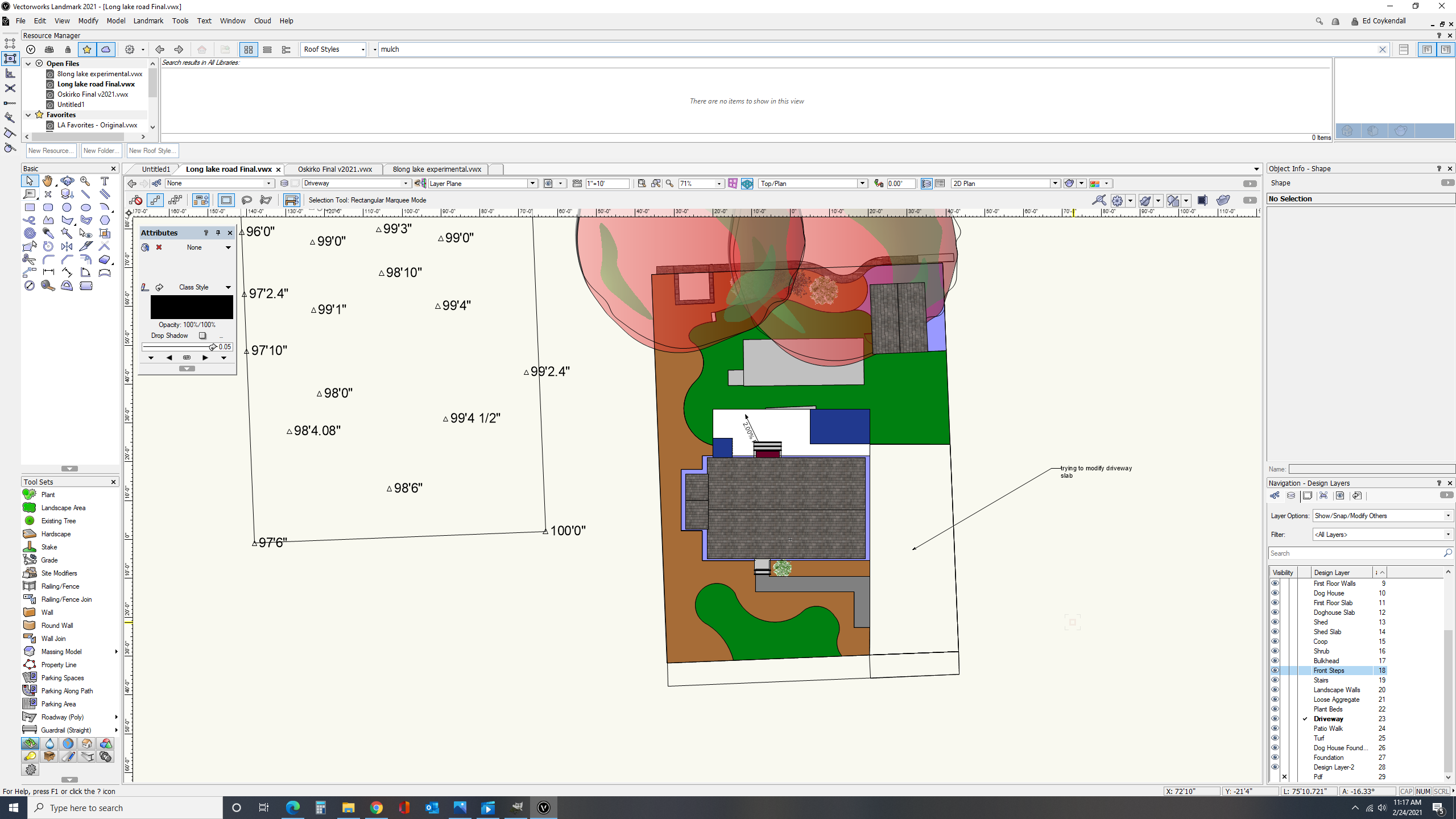

  6. That's my issue I can't tell.  I started to play around with regrading the site and running topo lines into my wall.  When I hit exit proposed site model contours the whole thing goes crazy.  I'm thinking I am clicking on geometry on my 0 plane.  OIP says its the site model at 0 elevation.  Any idea how it might have gotten to zero and should it even snap to zero my minimum elevation setting is 95'10" with a datum elevation of 2'.
  7. One of the reoccurring issues I have is with Site Modifiers, Hardscapes, Stake Objects and Grade Settings on objects pinning to the zero plane.  It looks like a matter of accuracy when applying the modifier.  How do you determine exactly what the source of the issue is here.  In this case I am trying to regrade the site using Edit Proposed Site Contours mode both site model contour mode and reshape mode.  keep getting these projections of grade from finished to 0 or in one case 2.33'.  Insights anyone?  Also excuse if my terminology is incorrect.  I'm figuring out how to do the grading.
