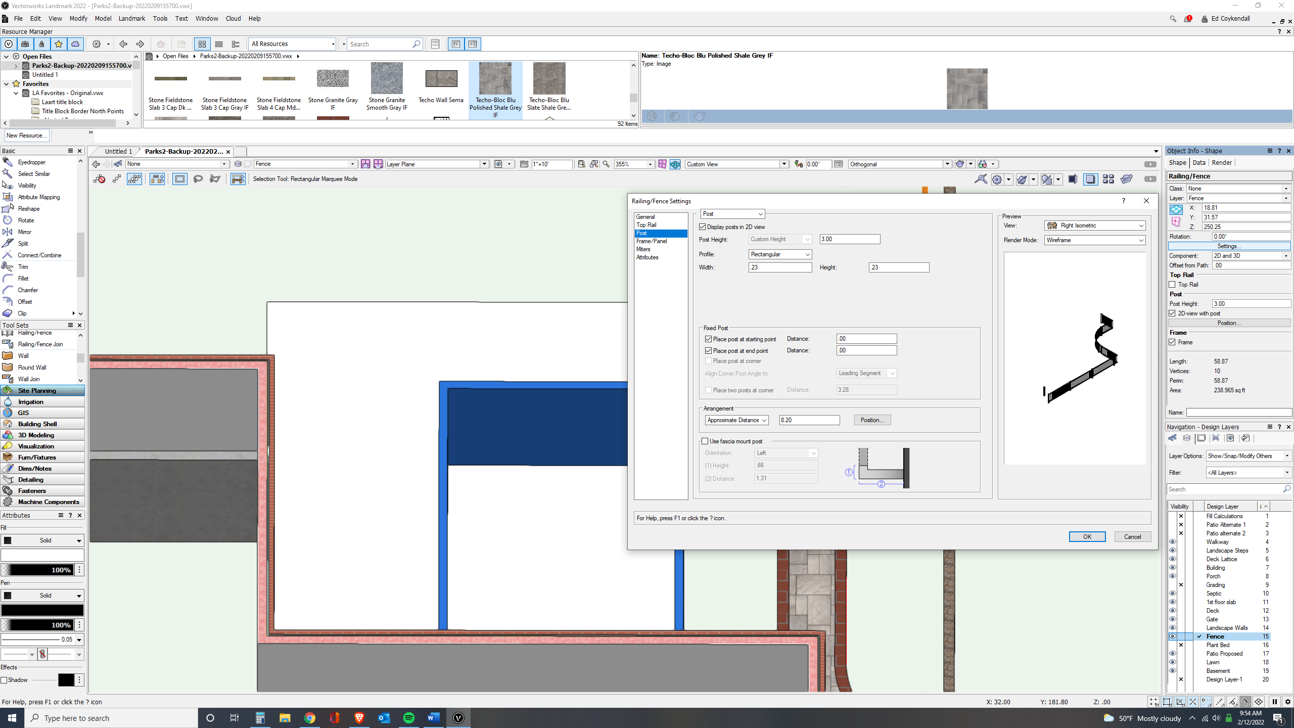

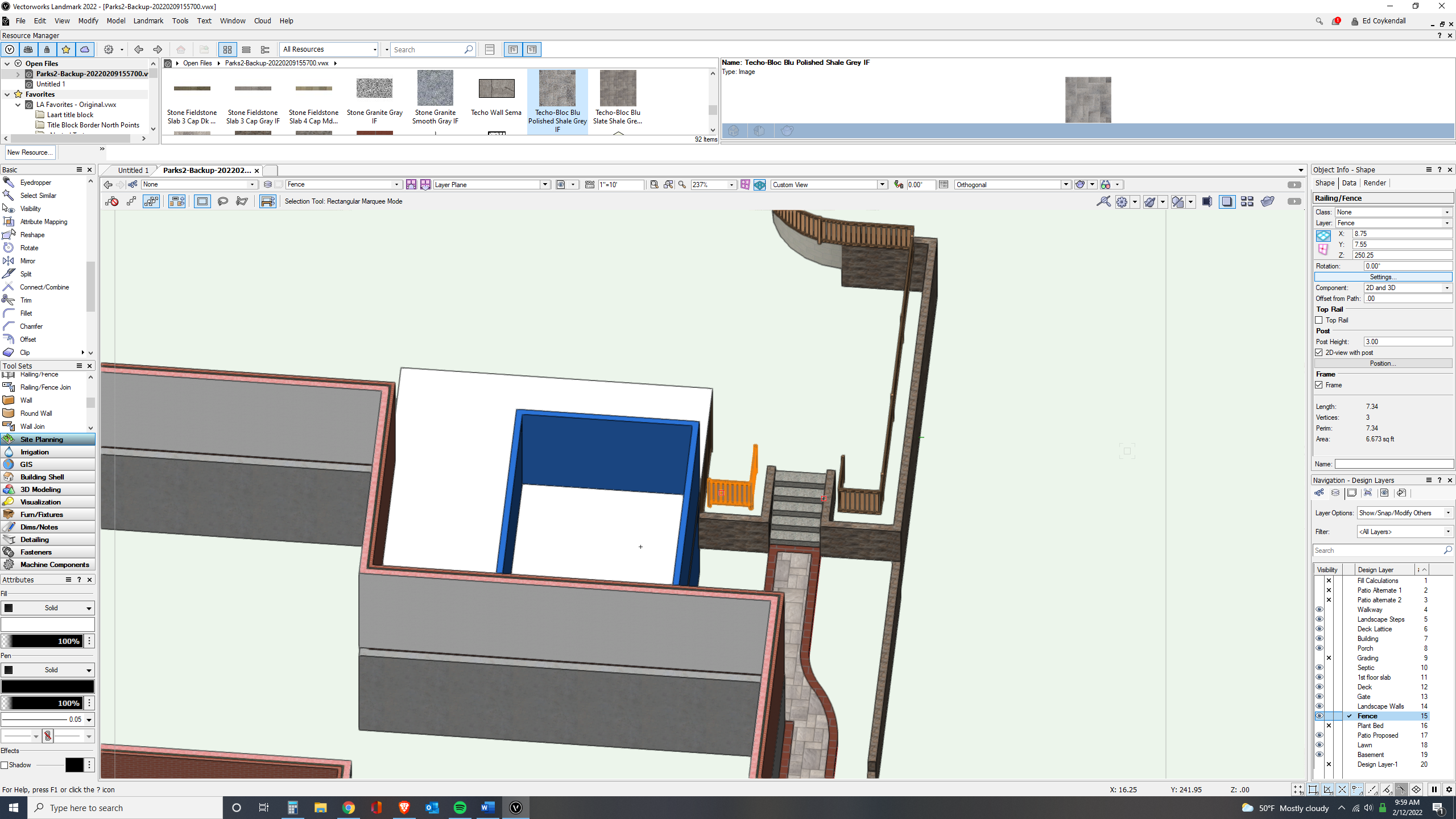

I'm laying out a fence/railing above a retaining wall and all settings between the two fences are the same but on one side I am not getting the option to Place Post at Corner so I am missing two sections of fence in isometric. Why is that? The odd thing is that I switched to another style I created and now I have the whole fence and looks as drawn in 2d when put into isometric.
