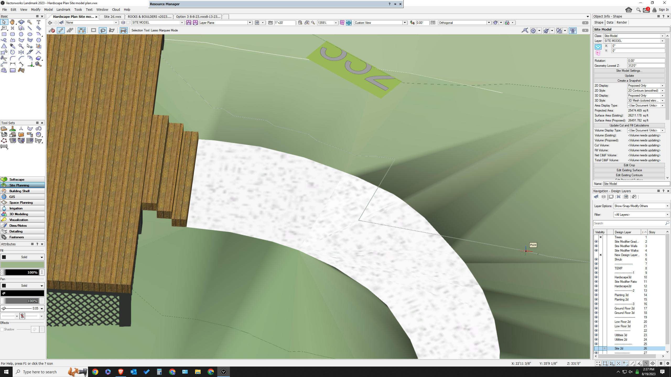

I have a drape over my site model. The update site model give a funky jink in on of the contours so I went into edit site model-proposed contours-reshape-delete vertex mode. I made my changes and hit Exit Proposed Site Model Contours. The change does not save. I went through the videos and can't see what I'm getting wrong. What setting am I missing? This has got to be really simple.
Thanks Tom...I was in there a few times I must have just had it set wrong. There will be other modifiers. I have to put in some pathways that I'm going to attempt drape. I have the modifiers on the site model layer with the site model. I've also tried a custom set of layers. But loe and behold I went through the layers communicating exercise again it just worked. The file is doggin...taking up a bunch of memory and going slow. I thought I had it cleaned up pretty well from the engineers...That's one thing I need to get ahold of. Thanks again Tom!

I just started developing this file and my site modifiers have seemingly stopped working. They are set to Proposed on site model and modifiers. Modifiers and are all set to communicate with a custom set of layers. All are site dtm modifier class except my site model. I have grade limits set. The only thing I have done since the last project is to do the update to service pack 6. Prior to that the modifiers were working as they should and I did a quick fakeup design and they are working on that. I think I must have an obvious setting off but I can't find it. Can anyone spot it?

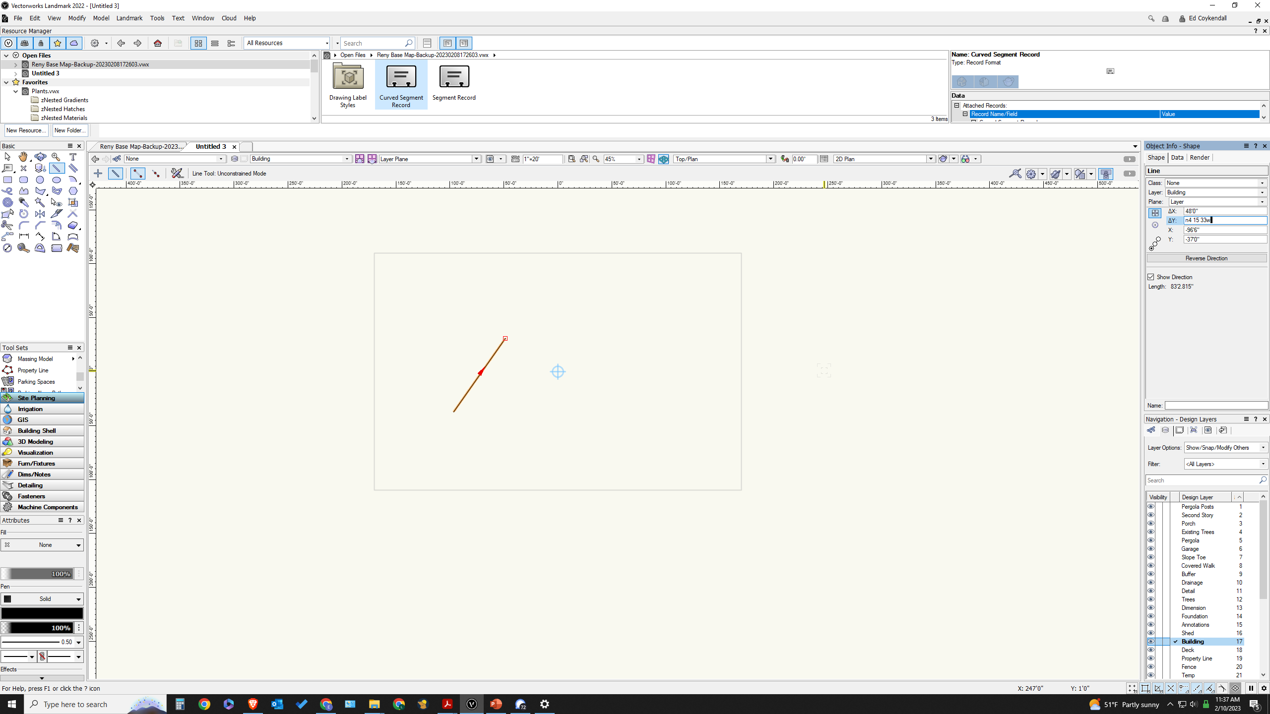

So you need to enter degree minute and second symbols. The videos I looked at say you can just put in the values N45 15 75W for example. It does work for the property line tool.
Yup I use that function frequently it is a time saver. And thank you for offering the help. So here's a question. When I went to use the line tool, set coordinates and it snapped to 0. I drew the line entered the coordinates ex n4 15 33w and it just snaps to 0 or does nothing. My guess is that I'm missing something simple.
It appears as if you have to have a closed object to convert to a property line or create an object from a shape in general. I was able to convert a simple square as expected. My intuition said since its a line I should be able to convert any line to a property line. Can Lines not be converted into Objects? I'm guessing that a line can not be defined as a shape and is unidimensional in the VW world. So I just figured out the tool...sort of. Its pretty easy to go back...I think. Anyhow I got it done but had to hack in my curves close the property then I was able to convert the rest of the lines. That's another learning moment.
I ended up figuring it out. My biggest issue with the tools, 3d work flows etc. is that the instruction videos run through a very superficial rundown of the tool. They very rarely go through the nuance. In this case it was how to back out of a line in order to redo a mistake. I watched it several times so if I'm missing something LMK. Now I need to figure out how to work the curve function. I ended up closing the dialog window repositioning the drawing then reopening. It would be cool if you could do it while the dialogue box is open. Enter the value hit next and it just moves on to the next point then you can hit Add, Update, Previous or Next. I messed with that for a while and think I have it down. Again a video with a bit more time spent would be useful. I've found that once you understand a tool they work pretty well. Its getting that understanding that's the challenge.

I have on old hand drawn survey that's way off. I attempted to use the property line tool to dial it in. It creates the line but as soon as I click done the line disappears/deletes. What am I missing.
