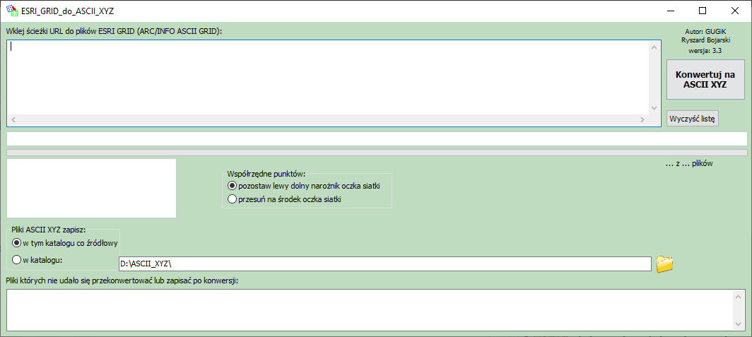

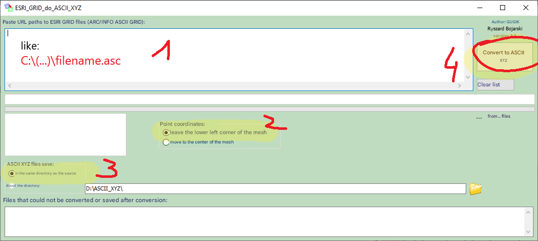

This discussion is rather old but I have find the way how to convert layers to classes one to one smoothly and easily. Please feel free to download my script Script does: convert layers to classes by creating classes with the same name as layers, assign object from layer to corresponding class. Script DOES NOT convert empty layers! You just have to manually move objects from source layers to desired layers by OIP or by activate desired layer select all objects and group (which will move all object to active layer as a group) Feel free to use and share with CC BY layers to classes script v2024.vwx -
