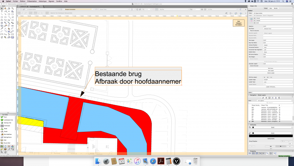

  6. Hello, Could someone help me with this ? I'm using the callout tool and the text seems to be offset. You can see on the joined print screen that the text is not aligned with the background color or the leader. How can I fix that ? I tried changing any property that could be changed but to no avail. Thanks. As a side question, is "callout" the best tool for this? All that "database center" thing make it look like callout has a whole other purpose.
