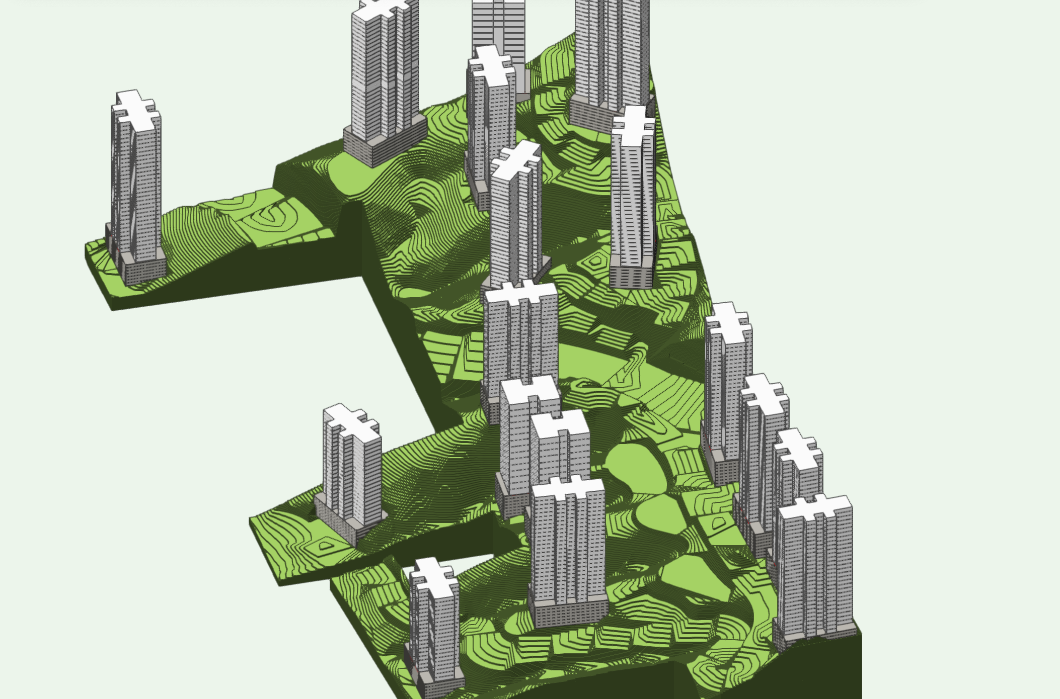

Hello! I have a big development project that has 18 apartment buildings. Since I'm working on a large urban scale, I have placed the buildings as massing models. But when I switch to open GL, weird things happen: 1. some buildings show drawn floors others don't 2. the lines from the buildings look weird and pixelated (edges) 3. same thing happens with my site model, it looks weird with some strange shadows (I don't have a heliodon object in my file) I checked the linotypes and attributes of the massing models, but can't seem to find the issue. Is there a way to smooth the lines in the drawing or something to correct this and make it look cleaner? Thanks!!

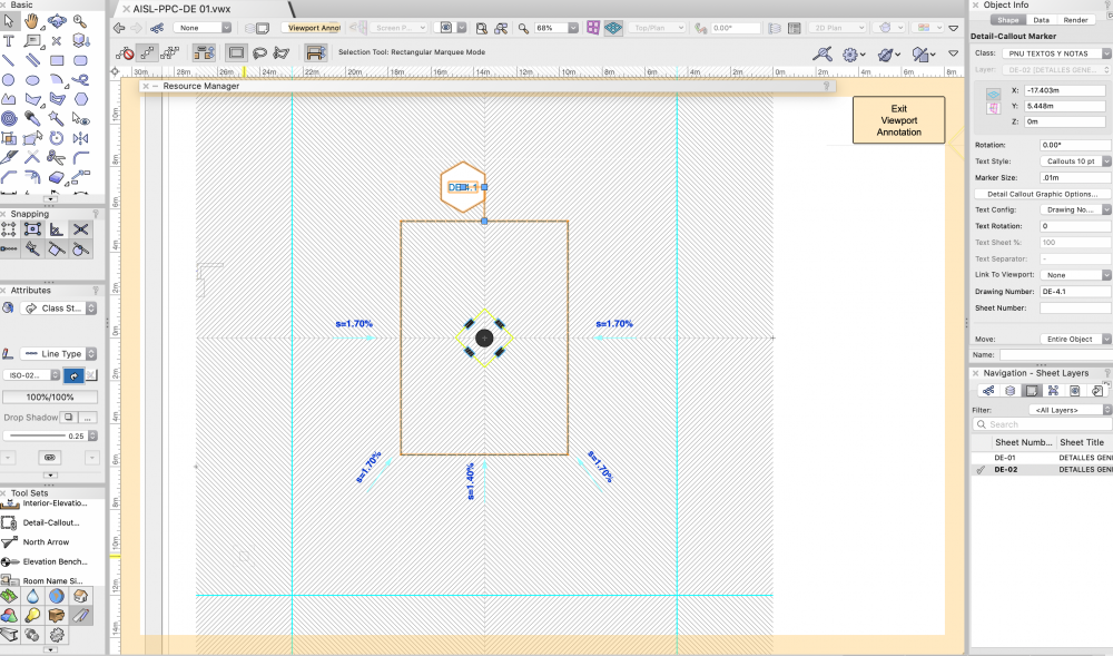

@Boh Yeah, I tried that, but the line from the marker keeps crossing the marker, if I figure it out I'll let you know!
@Boh Thanks for your help, I was able to edit the marker from the file in my application library, but now the leader line is on top of my detail text, and that doesn't seem to be able to be edited. Thanks a lot, hopefully someone will let us know if there's a way to change it!
Hello! I'm trying to edit a detail callout marker, but I can't seem to edit it from the attributes panel, and I can't find the marker in my resource manager. Is there a way to edit it? I want to remove the white fill where the detail number is, and change de the line color as well. Thanks!
