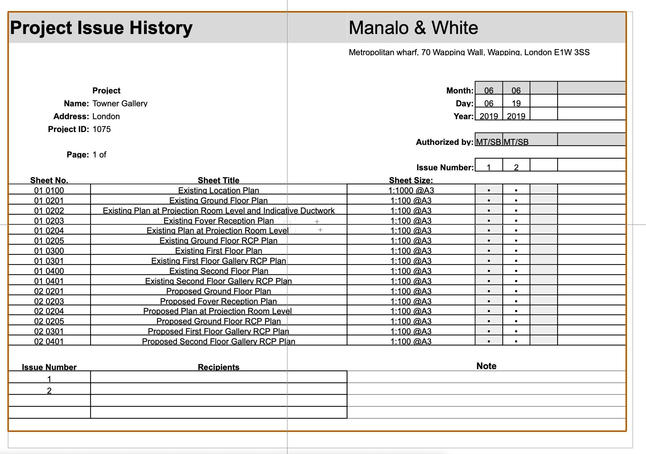

Thanks @Nikolay Zhelyazkov turns out the two weren't linking on the sheet because my colleague had retrospectively added issue numbers and changed the dates (so all of the revisions had been entered already). I've got it working now!
Hi All - Not sure if this should be a new topic but: Is it possible to have an issue register customised to show the revision number of each sheet at the date of issue? I've added a couple of screen shots to show the current default issue sheet and a butchered customised one which I've just written over the top to illustrate what I'm hoping to achieve.
