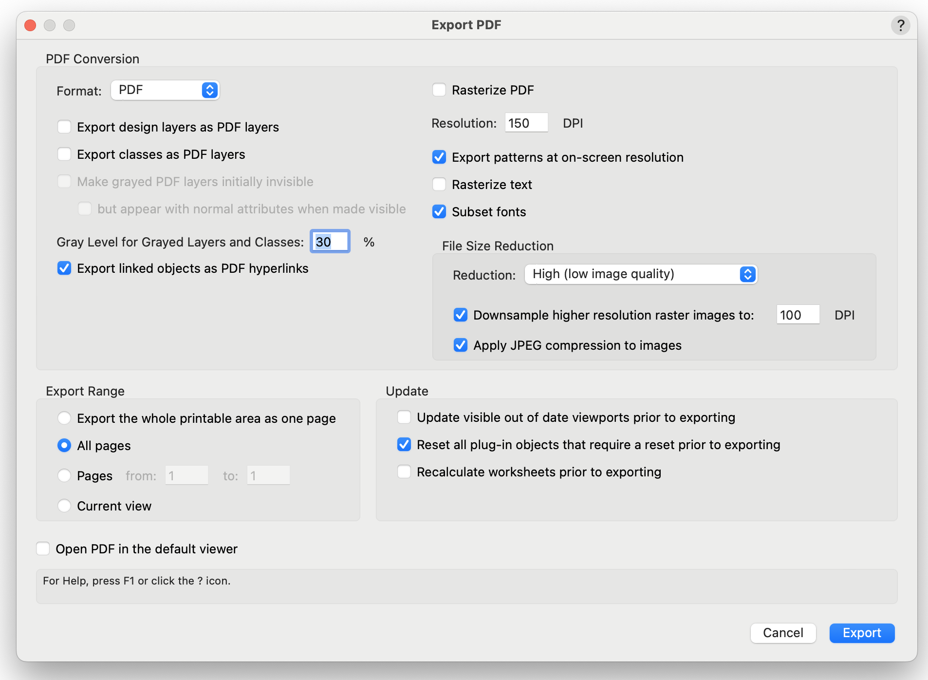

Cloud services shared document .vcdoc is blank when opening in browser
Pavol D. replied to Bertf's question in Troubleshooting
@Bertf we had probably same issue recently, resulting in blank shared document, and it was caused by 'Export PDF...' settings where we had 'Export Range' set to other than 'All Pages' or 'Pages'. Changing it to 'All Pages' fixed the issue. Try it out. Hope this helps. -
