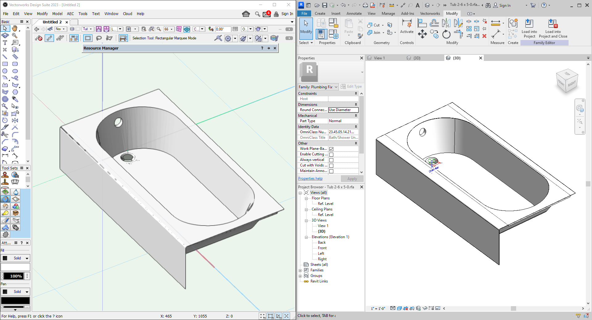

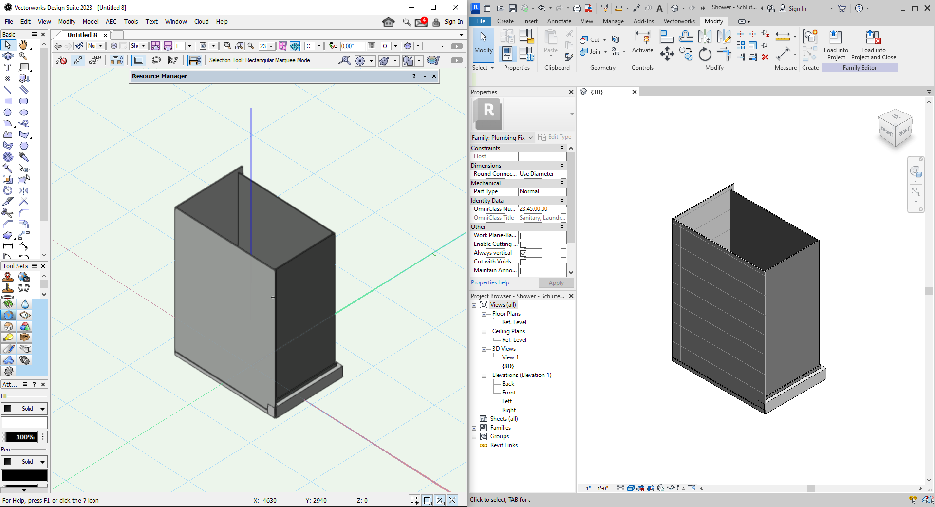

Vasil Kitanov replied to rudybeuc@gmail.com's question in Wishlist - Feature and Content Requests
Hi @rudybeuc@gmail.com, Thank you for the example files! Here is these files imported in Vectorworks and opened in Revit app side-by-side: Yes, for now Vectorworks does not import light objects as native, but with some additional actions (delete light source) you can get a nice solid lamp: This happens only when the internal process of creating a solid object fails. In this case the result is object created by 3D polygons and that is why the result looks tessellated. We recommend in this case to repeat the import process by using the "Vectorworks mesh objects" option - the object will look much better. We also want to achieve this kind of result on import and we are working to improve it, as we did for walls, floors, roofs, topography objects, but it is not an easy job especially when the file format is not open. Best regards, Vasko -
