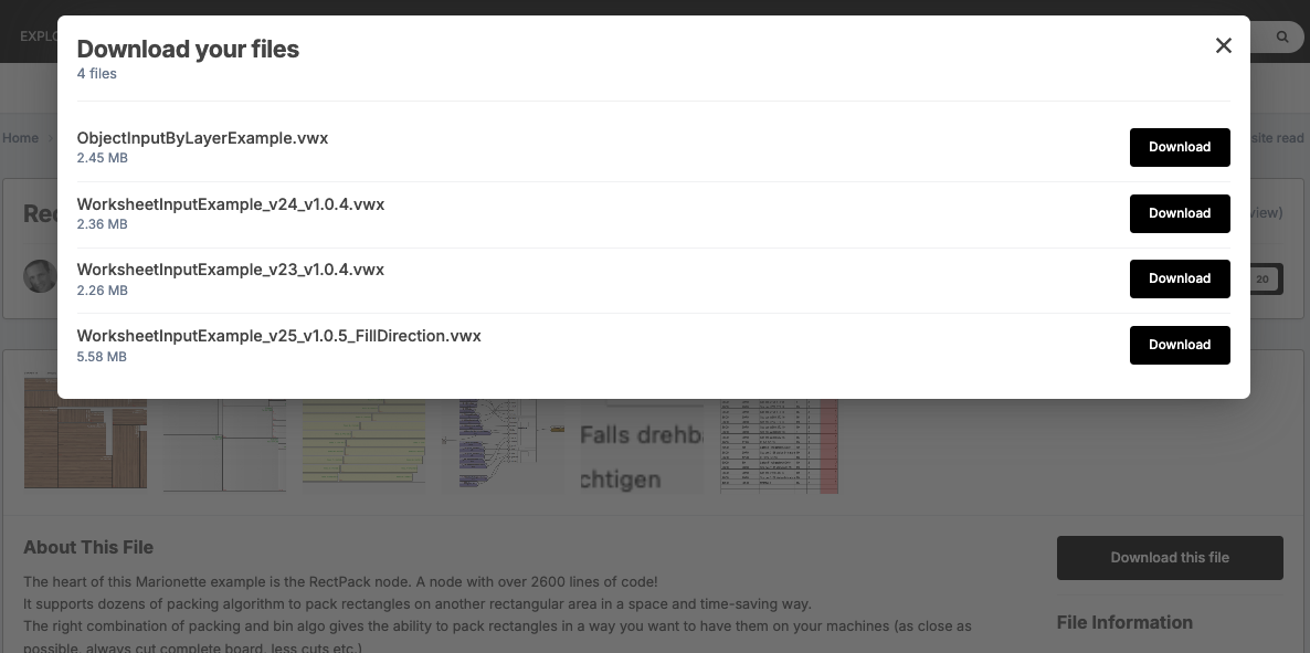

You should be able to Download it via the Button above "Download this File" Ant then you should see the different versions.
