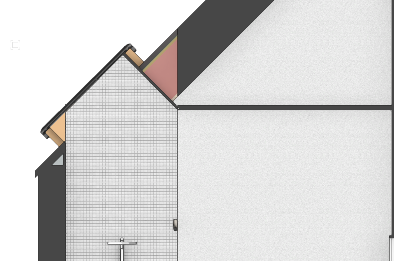

I am trying to have a skylight that has three walls going straight up into it and the other coming out of it square. So I need a roof opening that splays on one side and is square on three. Below is what I am trying to achieve. The problem is that I either end up with a giant hole in my roof (the link triangle) or I'll have roof jotting into my skylight on its lower egde. Does anyone know how to solve this?
