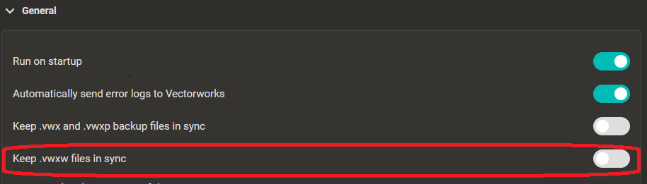

Cloud Service not syncing local folders on machines
Lyuben replied to Brian Nitz's question in Troubleshooting
@Brian Nitz In the settings of the VCS desktop app there is a control to turn on/off sync of working files. -
