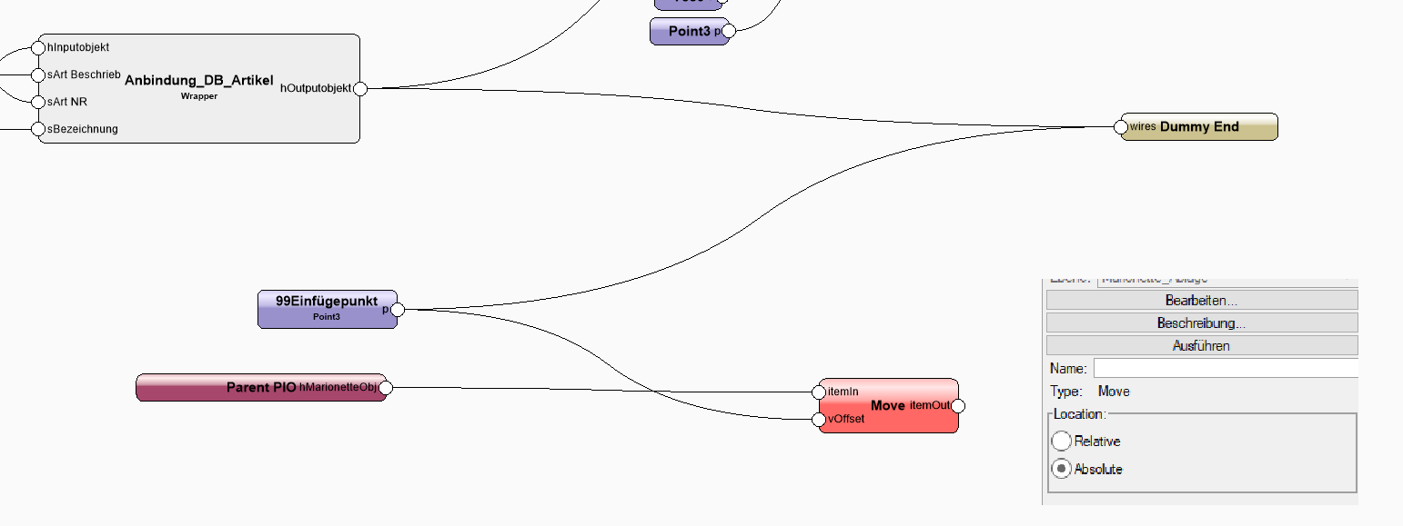

  14. Hey Marissa Is this node avayable? I would like to put an object node to an specific point in the file, but it only works in 2D-View. If I'm in a 3D View it moves it always like "relative". So I would like to set to Plan View an restore the view that was before. Sounds like the thing you were explaning...

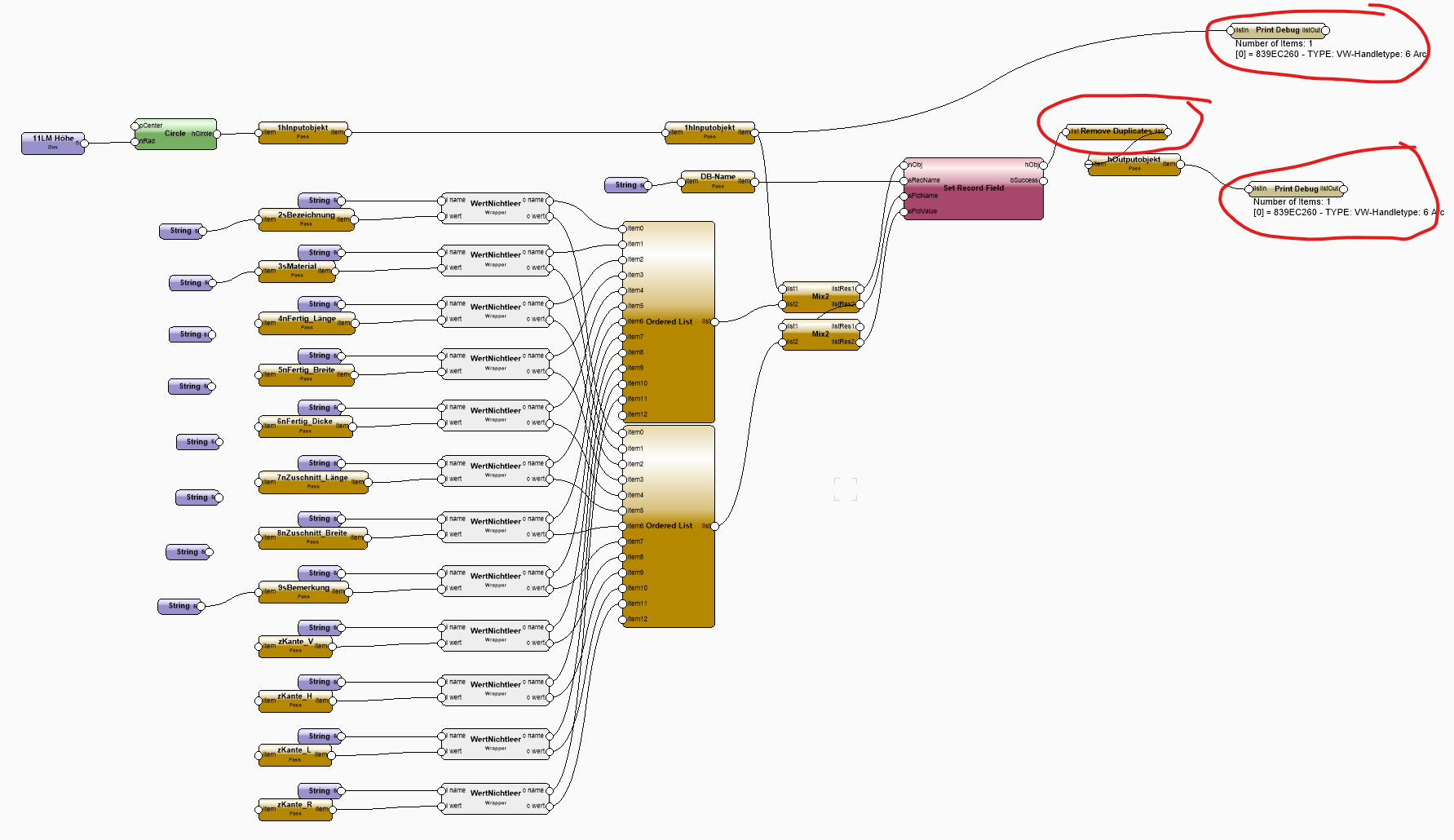

  15. I just realized a weird thing. If I connect an object with several record fields I got duplicates in the output. A Bug? It's easy to fix with a "Remove Duplicates" Node Wrong, If i want this object to move afterwards: And fixed:
