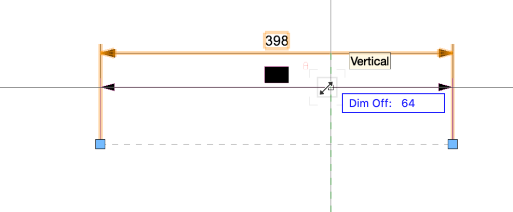

Display Issue with Dimension Text
in Troubleshooting
Posted
We have just started using VW26 Update 2. When re-positioning dimension lines, the text turns a solid black rectangle. Is this a known issue?
It doesn't seem to affect workflow, but is annoying.
Thanks
