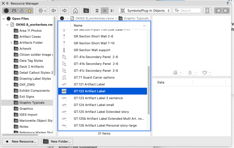

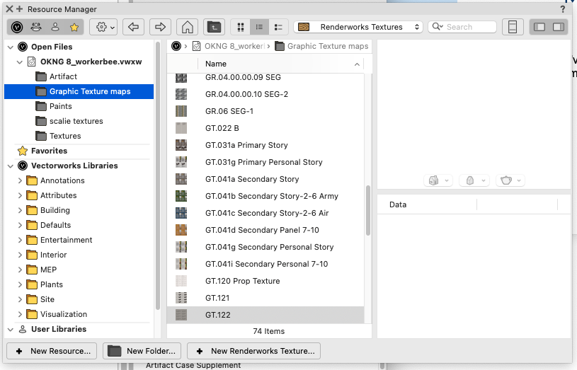

Multiple Resource Browser Windows.
iswope posted a question in Wishlist - Feature and Content Requests
I'd like to have access to two different folders at once without having to navigate back through the resource Manager. For instance, sometimes would like to have access to a folder of Textures and a set of symbols. so I don't have to go back and forth between the two. Other times, I am tagging items in viewports and I find I need to access a symbol, I navigate to the symbol and fix it. To continue my tagging exercise I need to navigate back to where my tags are. It would be nice if I could open two windows one with the Tags and one with the symbols. -
