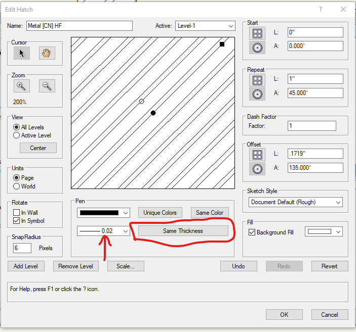

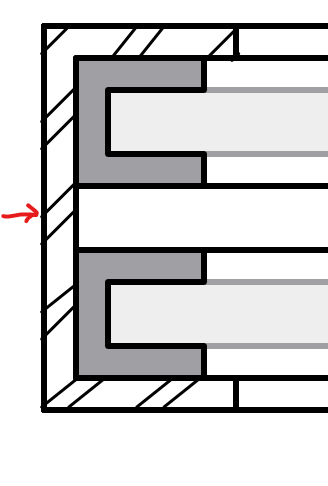

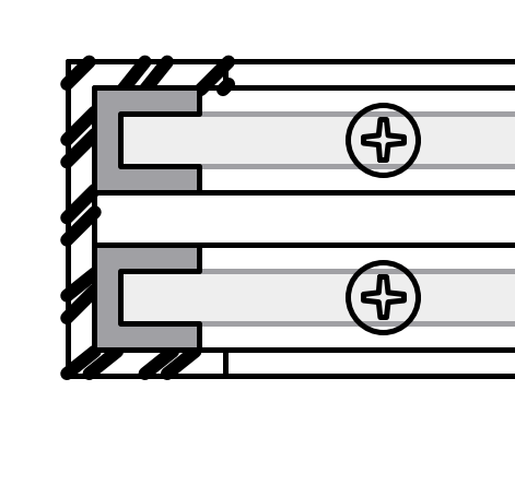

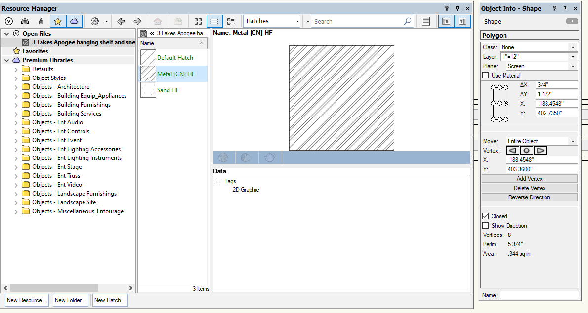

  2. Thank you very much for the fast replies, Tom. The Vectorworks help seems to assume one knows all this stuff, it's not very intuitive for a person like me not immersed in the program's nuts and bolts. I knew what I was seeing didn't exactly match what is shown in the help files, but had you not told me to slide that pane over I would still be twisting in the wind. I also discovered that I had to make the hatch lines as small as allowed to keep them from appearing to extend beyond the object when zoomed in to a small scale. I also had to select "same thickness" because otherwise it was a mix of line thicknesses. Don't understand that, but I dont need to, this is the fix I needed at the moment. Here's what it looks like zoomed in at 1"=12" scale. Wonder why the hatch lines still appear to extend beyond the object lines? I know its kind of nit-picky, but I dont get it. I suppose nobody else notices this...or cares!

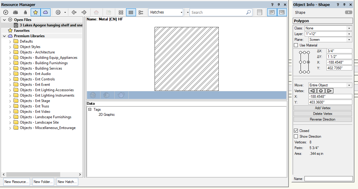

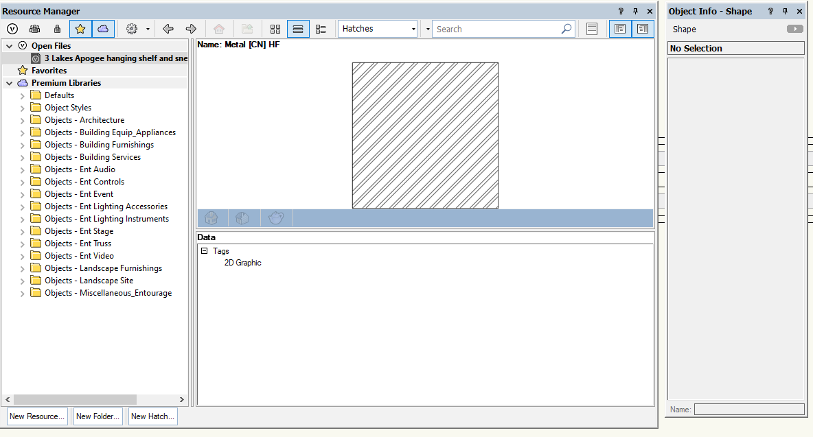

  3. Thanks Tom. I am not educated enough to get there apparently. I clicked the object and located it in the resource manager but I cant find anything to click on that says "edit hatch".
  4. In a smaller scale 1"=12" its even worse. Looks terrible.

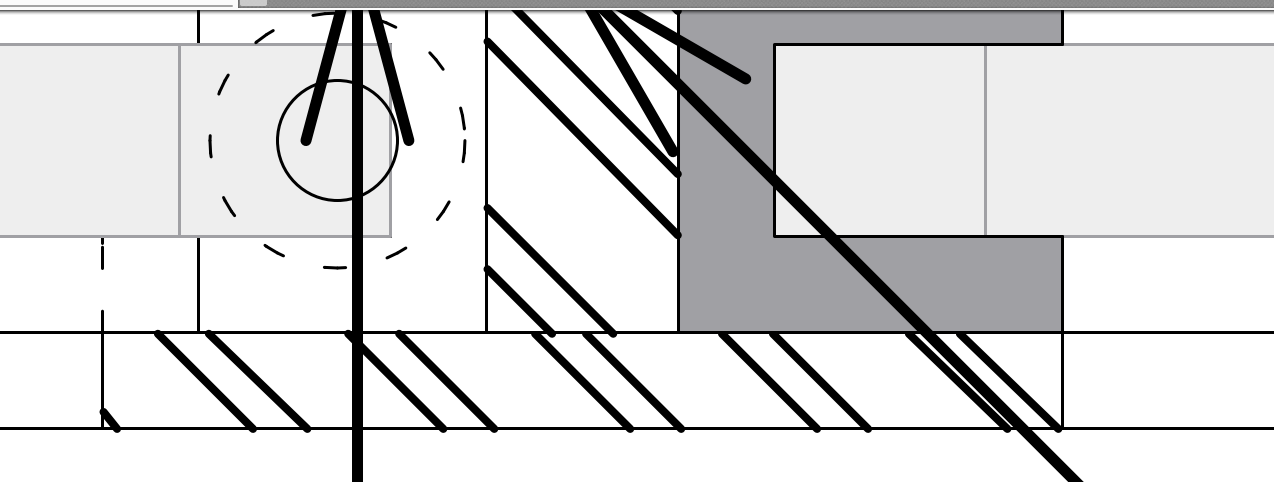

  5. V2021. When using a hatch, in this case the Metal hatch, when you zoom in to a .pdf export the hatch is chubby and looks like it extends beyond the boundary of the object. Is there a way to change the line weight on a hatch? Looking at this snip, my leader lines are 0.18mm, my typical drawing lines are 0.05mm. Those hatch lines appear to be somewhere in between.
  6. Thank you! Editing one changed them all to 12pt, what I wanted.
