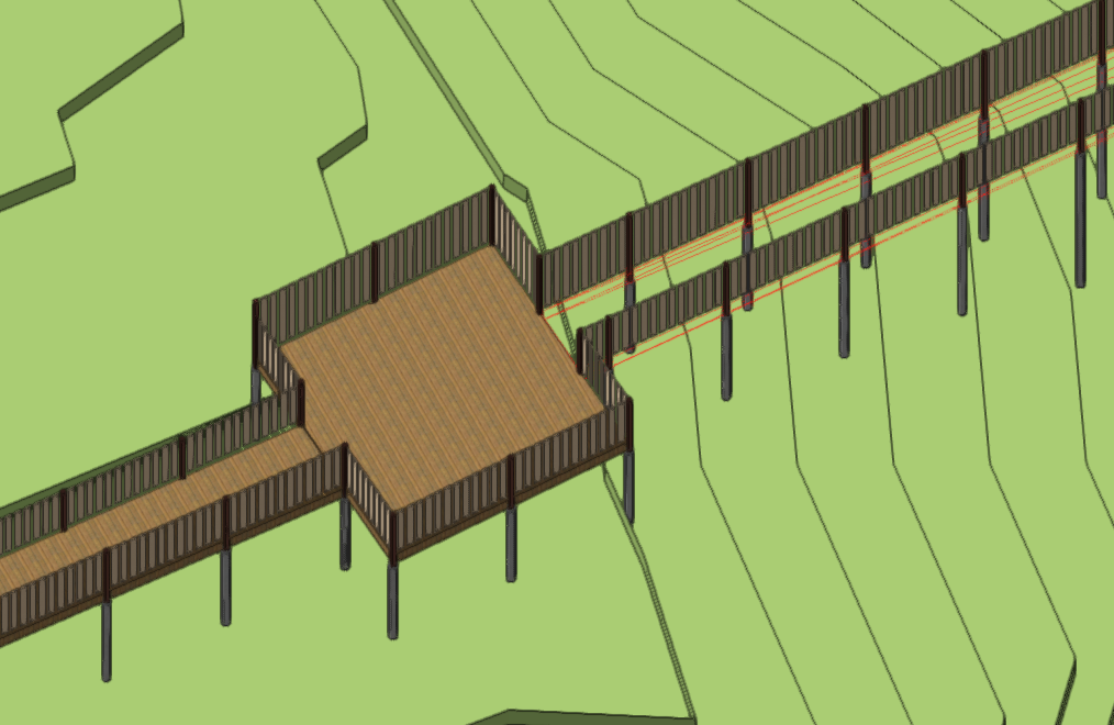

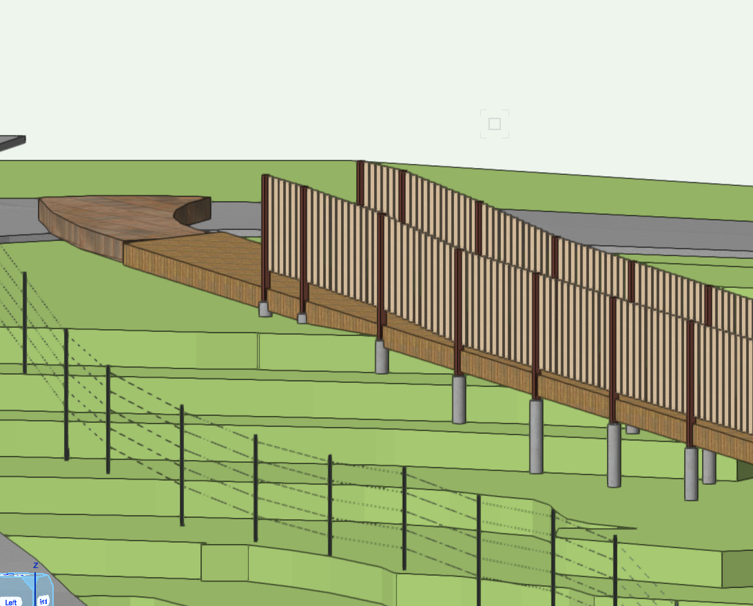

Thankyou for looking at that. I basically copied everything into a new file, ignored the incorrect georeferencing and set the origins correctly. I still couldn't get the boardwalks to work correctly so drew them again ( a lot quicker the second time around) and it now works fine. You mention a hardscape which is separate from the model - how do I draw a hardscape which is to a fall which does not affect the site model below? Do I keep the site model on a layer which is not affected by the hardscape or is it a particular style of hardscape? All the hardscape over which I can control the grade (i.e not draped) seem to affect the site model. What's the best way to achieve this? I also have a small problem with the the fence along the hardscape. The majority of the fence (using the fence tool) is following the surface of the hardscape - I have set it to send to surface - hardscape, and checked the fence is actually on top of the hardscape but there is one section where the boardwalk cuts into the model surface slightly and the fence is following the site model surface, not the hardscape and rising up a little. How can I correct this? If I set the hardscape to cut into the site model it makes no difference. Do you also know if it is possible to produce a site section or a section viewport which is not just a single straight line i.e. I want a section along the length of the boardwalk and I can only find how to get a single section which does not allow for the change in direction. thanks for your help. Helen 191 Stansfeld Walkway Finalvwx.vwx -

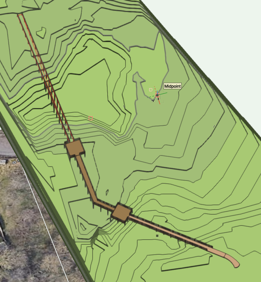

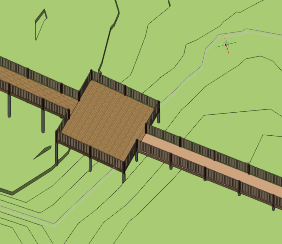

I have created a sloped boardwalk with fence using hardscape and fence tool, with level platforms and sloping boardwalk. It mostly sits above a site model, but occasionally cuts into it. I am really struggling with the rendering. All the sections of boardwalk are in the same class, with a timber render selected, both in the class and individually, but some sections render correctly, some just show the flat 2d colour and some show just the red site modifier lines. I cannot seem to get this to work consistently. If I try to render I get the warning 'cannot apply texture to object'. Any ideas? thanks Helen Landmark 2025 SP3.

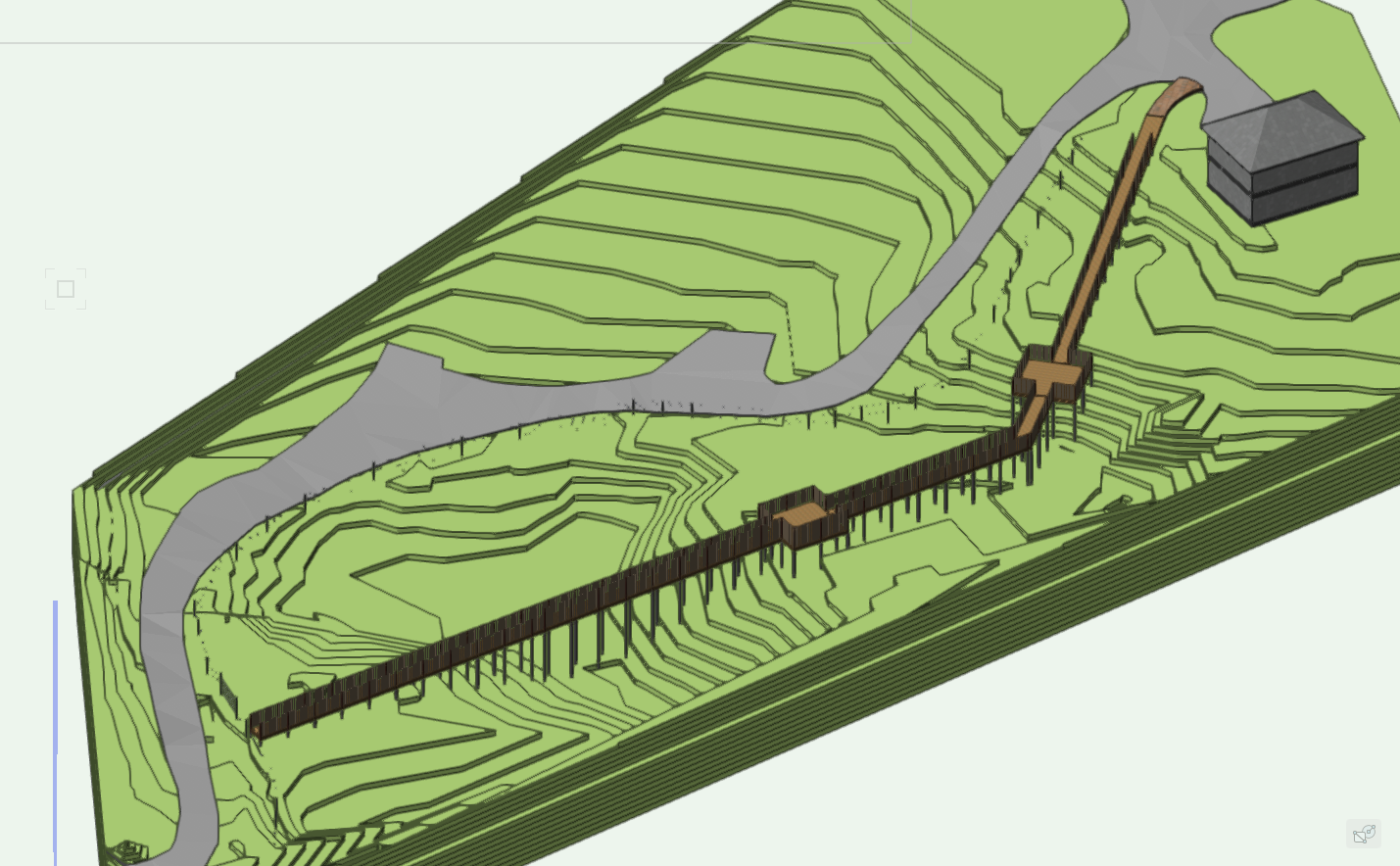

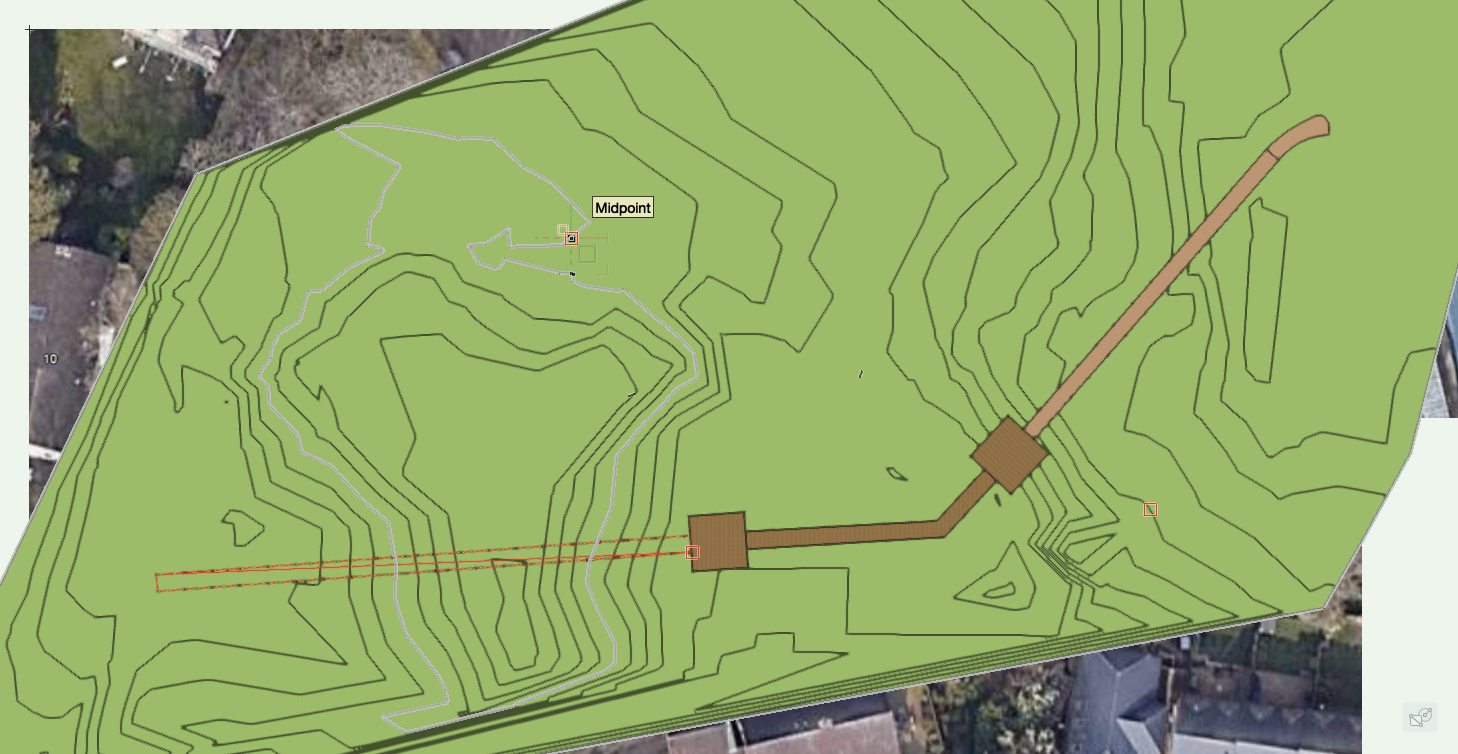

I am trying to create a boardwalk which runs over a landscape for which I have created a DTM. I need the boardwalk to float over the DTM without modifying it but I need the boardwalk to follow a set gradient. I can create this using a hardscape but am struggling to get the profile correct. If I set the start and end elevations the hardscape is twisted which is not what I need. If I use it as a planar pad the slope can be set but it is sloping across the boardwalk rather than down it. Also as it's curved I'm not sure how accurate this would be. Is there a better way to create this? The boardwalk is winding through trees so is not straight but curved. Would it be better to use a roadway, a tool which I have not used before? I can use the gradient tool to modify the DTM but can I also use it to modify a hardscape which is not part of the DTM? Screenshots below. The brown area is the boardwalk which sits above the model surface. The grey is a road on the model surface. I need the boardwalk to meet the road at both ends at an approx grade of 1:20. thanks for your advice Helen landmark 2024
