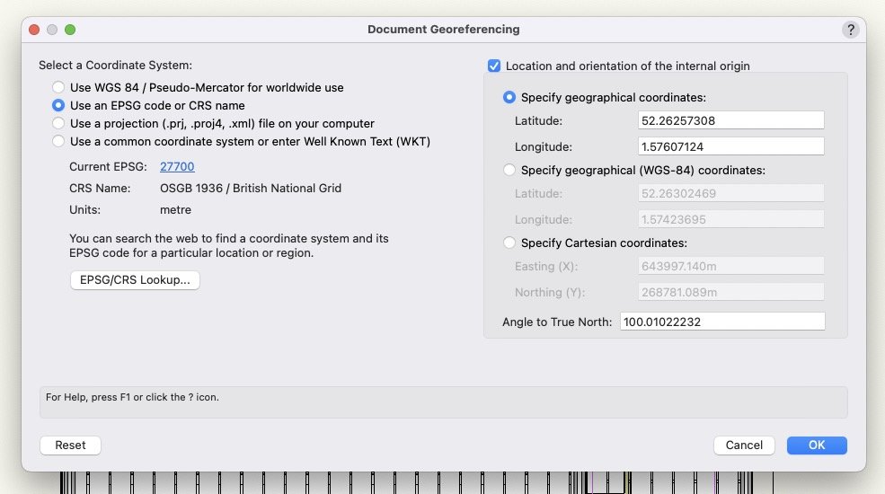

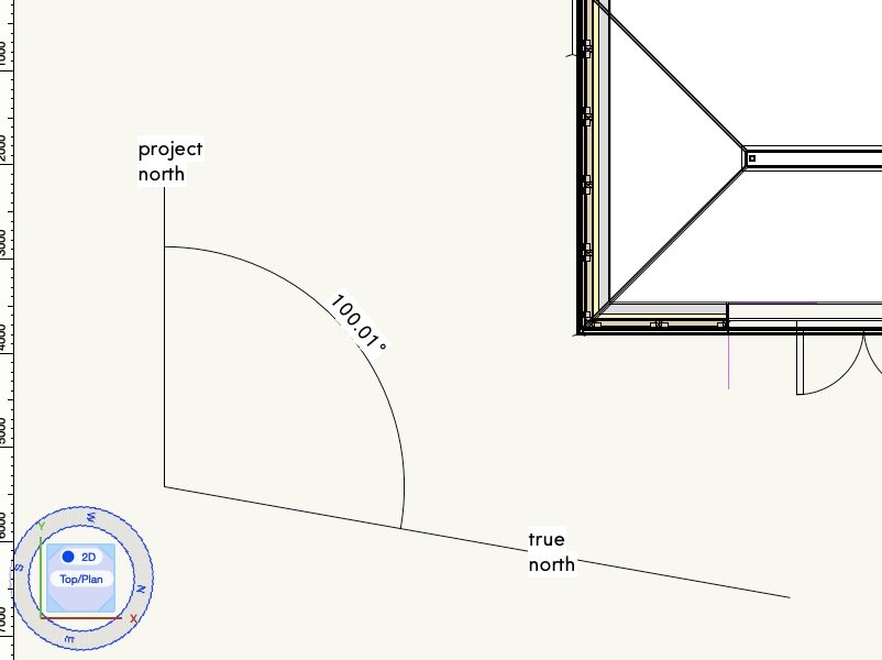

Question is, how to do this exactly? I realised that I can find a numerical value for the angle between project & true north here: I then manually drew a line at that angle from project north, which lets me find true north in the drawing: And now I have something to align my north-points and heliodons to. It feels like it should be much simpler than this though...VW knows where true north is, so it should be able to align objects with it.

This is a screenshot from a georeferenced file, where "project north" doesn't match actual north. The compass ring is very handy for keeping on top of what direction everything is - I like that I can always see where real north is, regardless of the orientation I'm looking at the drawing in. But is there any way to draw anything in the file, in such a way that it's exactly aligned with real north? The north point tool seems unaware of where real north is. And so do heliodons. I'd kind of assumed part of the point of georeferencing was so that these kinds of objects would automatically point the right direction. Anyway, they don't, but I can't work out how I can rotate them to exactly the right angle, other than by some very tedious process of pasting a map or plan with north marked on it, into the file, and then manually rotating it to match the model. The pink line in the screenshot is drawn by a version of that process, and then I have to line my heliodons up with that. But am I missing something?
