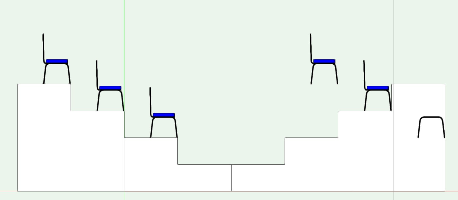

Hi, I'm trying to mirror seating sections created using the event tool. Whenever I do this, the seats are duplicated, but not mirrored. I've attached a couple of screen shots. Am I doing something wrong, or is this a bug?
