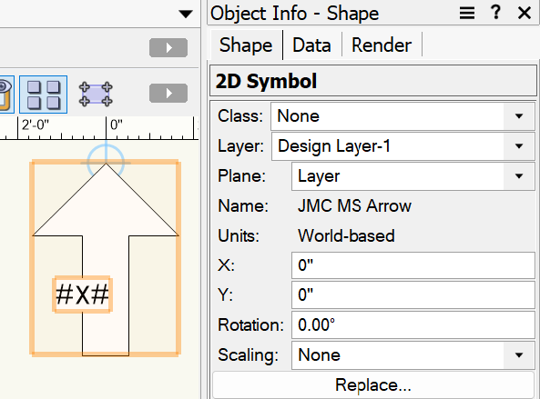

Hey Pat, Thanks for your response! My code now looks like this: PROCEDURE InsertMSArrow; {Inserts an specified Symbol arrow and adds a User Definable Text Field} VAR X1, Y1, X2, Y2 :Real; BEGIN GetPt(X1,Y1); {gets point from mouse click} Symbol('JMC MS Arrow', X1, Y1, 0); GetPt(X2,Y2); {gets point from mouse click} MoveTo(X2,Y2); CreateText(pTextData); End; Run(InsertMSArrow); But the object shows me the attached when inserted. I'm not seeing a field in the OIP for the TextData, and they appear to be two separate objects. Any thoughts?
Hey Raymond, Thanks for this! I’ve done it that way before, but my long term goal is to make a script based PIO to make the text be read normally no matter how the object is rotated. I think I found the code to make the rotation happen, but (I think) I’d need it to be built into an PIO object first. I’m also hoping to eventually be able to control the color of the geometry inside the object on a per instance basis, which I don’t think I can do as a symbol. Thanks!
Hi there! I'm slowly digging into this all, trying to do some basic things before I go for more complicated scripting to make sure I understand how it works. Right now I'm trying to insert a symbol and a text field into the drawing, and let the text field be adjustable in the OIP. So far what I'm seeing is that it will draw the symbol and text field as two separate objects (symbol and text field respectively), where I'd like to have them be one object together. Below is the code I'm using- it's a Point object so far. PROCEDURE InsertMSArrow; {Inserts an specified Symbol arrow and adds a User Definable Text Field} VAR X1, Y1, X2, Y2 :Real; textData :String; BEGIN GetPt(X1,Y1); {gets point from mouse click} Symbol('JMC MS Arrow', X1, Y1, 0); GetPt(X2,Y2); {gets point from mouse click} MoveTo(X2,Y2); CreateText(pTextData); End; Run(InsertMSArrow); What can I do to make this function properly? I'm sure I'm missing something pretty basic. (Eventually, I'd love to be able to click once, and then click to set the rotation of the object together, if that matters for advice!) Thanks! I'm hoping once I get past some of this stuff, I can hit the ground running!
