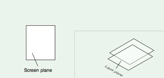

I think I know why your extrude isn't going in the right direction.
In VW you can draw 2d objects on the screen plane, layer plane, or an other working plane. At first this seems a bit odd, but when you get the hang of it it becomes a powerful tool.
Screen plane is only for 2d drawings and always 'glued' to your screen.
Before you draw a rectangle you can change on which plane you draw:
Lets try something:
- Go to a front view
- set the working plane to layer plane
- draw a 2d rectangle
- extrude the rectangle with the push pull tool or ctrl-E
If I'm correct the object is now extruded in the correct direction.
