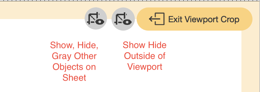

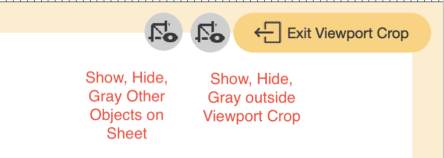

Each button could also control On (Black - Full Color), Off and Gray for the Viewport and the Sheet. But if you wanted a maximalist four button layout that's fine too, as long as the other dialogue box controls go away. Seven areas to control the same info would make my head explode! 🤣 -

Yes. I didn't know what to call that button, but referred to this document for some shared terminology. -

Oh.... The controls are toggling what's in and out of the crop window, but they are not toggling what's in and out of the page/annotations, which may be working as designed but which is kind of odd. It feels different from the Edit Annotations Onscreen Controls because there is only one level of hide/show to toggle. -

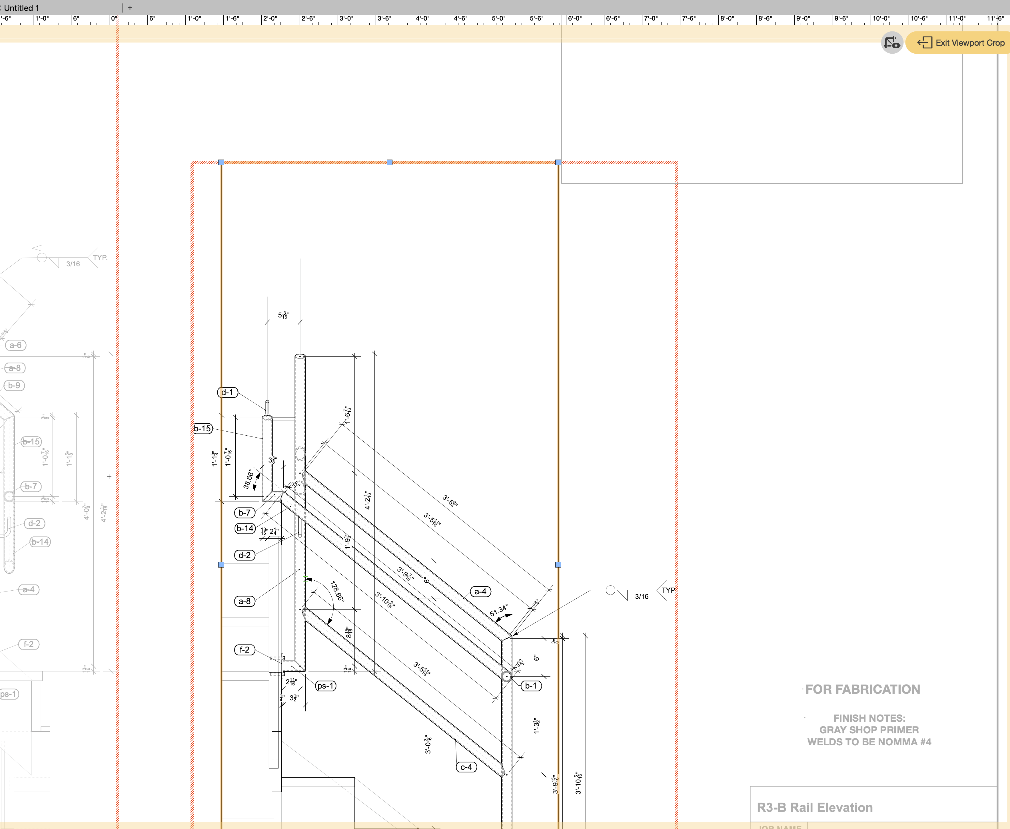

Perhaps I am not understanding some aspect of the new VW26 functionality, but the Onscreen View Control Button does not appear to have any effect while editing a Viewport crop. The video posted above shows what I am experiencing. This problem may be specific to my machine, my OS, or some configuration of all the various preference settings. Is this how the controls were intended to function? -

@Tom W. I will explore this further, but I am not experiencing consistent behavior in the edit modes you highlighted with the crop tool. -

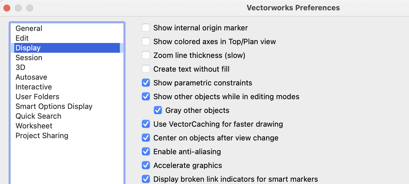

Make sure your VW preferences are set correctly to Show + Gray other objects while in editing modes. For a while, 2026 was behaving as you describe above. I tried a bunch of things but couldn't see anything outside of the crop. Then I clicked off Gray Other Objects and then clicked it back on. After resetting things, VW26 now allows me to see other objects outside the crop window. -

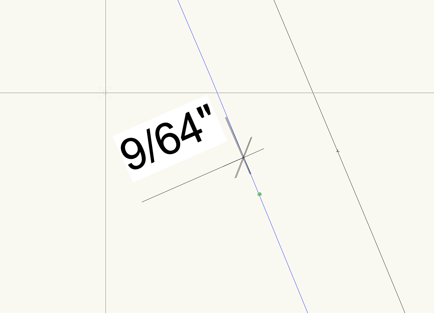

Even if I create a NURBS Curve native using the Create NURBS Curve tool, Duplicate along Path does not accurately place loci on the path. It places them "Sort of" on the Path, which is maybe what the tool should be renamed. 🙂 Duplicate "Sort of" Along Path.

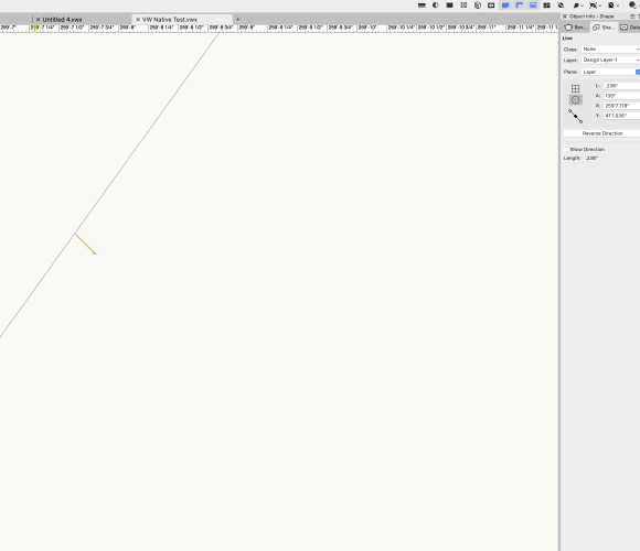

I don't think that's the issue. Everything in this file was done in VW. Duplicate along Path still places the 3D Locus point .238" [6 mm] off the curve. That's not particularly accurate, and it makes me question what else may not be accurate. VW Native Test.vwxVW Native Test.vwx
The curves are developed from survey elevation points along a bike path edge. They were laid out using a station point and elevations along a 2d Vector. The 3D NURBS curve was then offset. All of this was done in Rhino, as it was easier for me to accomplish those tasks in that program. Rebuilding the curve in the VW 3D Power Pack Toolset regularizes the geometry somewhat; however, it does not entirely resolve the issue. I can reduce the offset to about 1/64" [.4 mm], but the 3D loci still stray from the path. If the points were on the curve, you could use the Point Split tool and split the curve at the locus point. I cannot do this. There must be a mathematical error, or VW may not be well-suited for accurately duplicating objects along a complex 3d NURBS curve path. I can deal with the imprecision, as it's within striking distance, but there's certainly room for improvement.
Thank you @VIRTUALENVIRONS and @Steve S. I am not super fluent in NURBS modeling. Realizing my earlier segmentation error, I wound up rebuilding the curve and recreating the required work line overnight. I was trying to figure out how to stay in VW, if possible, since most things can be done here, but often with a different approach. Upon laying out work points for some 3d elements, I encountered a different Vectorworks problem. When I duplicated a 3D locus along newly created (hopefully legitimate) NURBS Curve, I noticed that VW (maybe?) did not accurately duplicate the 3D loci along the path in blue. At the end of the path, the locus appears 9/64" [3.58mm] off of the work line. Maybe within construction tolerances, but perplexing nonetheless. I am confused whether this is a graphical resolution issue, or an actual geometry problem. Is the duplicate along path tool the best tool for this application? The idea was to set centerline geometry along this layout curve. New Curve + Duplicate along path.vwx
