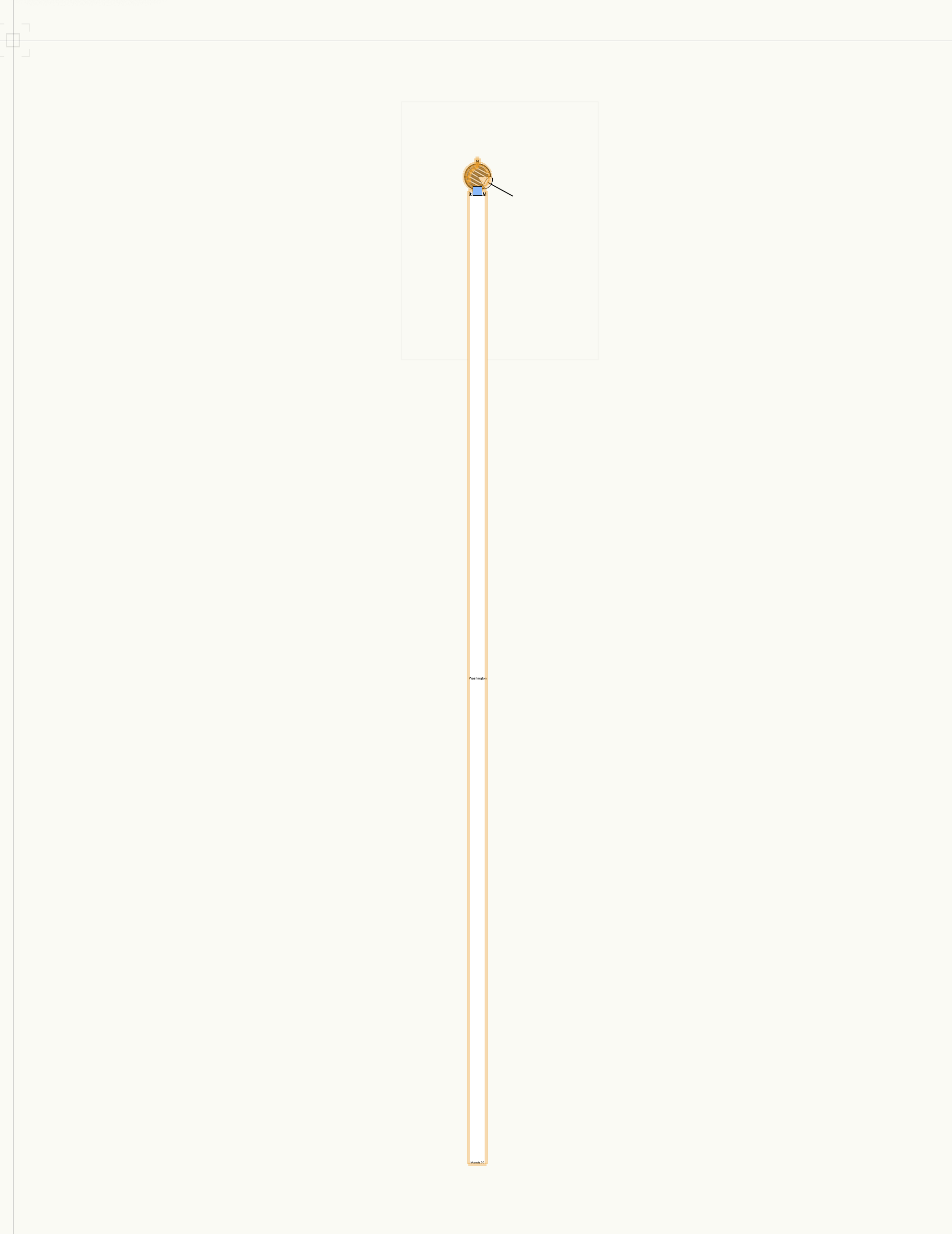

In current versions of VW2026, the Heliodon object now has a massive bounding box when you show the time and location. Turning off the time eliminates the box size, but when you have multiple heliodon objects, it is useful to keep the time visible.
