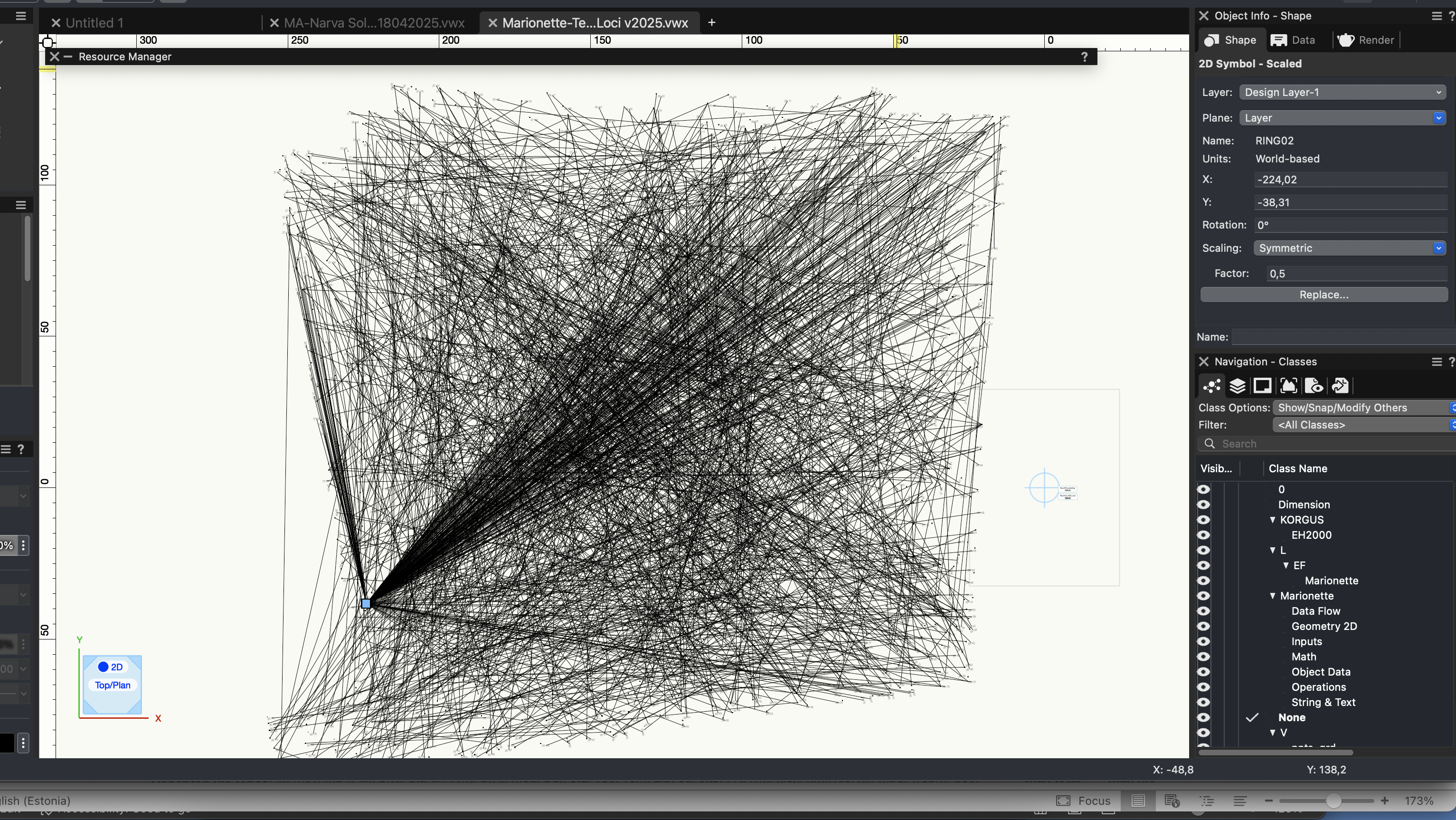

I face the same issue but in the metric system. It is ok if the topographical survey plan is in metres and the drawing is set up for these units accordingly. When the drawing is in millimetres, Once imported, I switch the units to metres; run the Marionette script and turn back to mm. Nevertheless, it would be good to know what node to insert to convert one unit to another, e.g. metres to millimetres, by multiplying by 1000. I was looking into Simple Maths nodes, but Mul requires values from two other nodes - as far as I understand. I am sure it's easy when one knows what different nodes do.
Any help with this?
