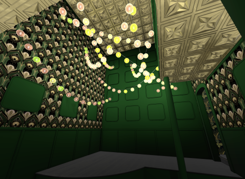

Peter Neufeld
   1 of 1 member found this review helpful 1 / 1 member
Dear Sarah,
This is great and so easy to use! It's a great example of what Marionette can do.  My living room will never be the same again.
Cheers and thanks,
Peter
  • Like 2
Link to review
