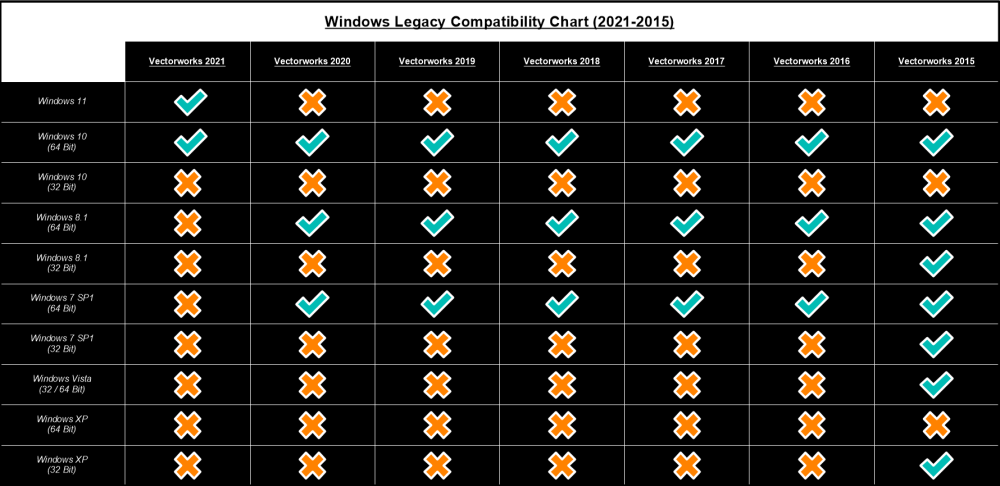

    The below charts show the OS compatibility for unsupported legacy versions of Vectorworks software. For more recent version compatibility, see THIS ARTICLE instead.
    WINDOWS:

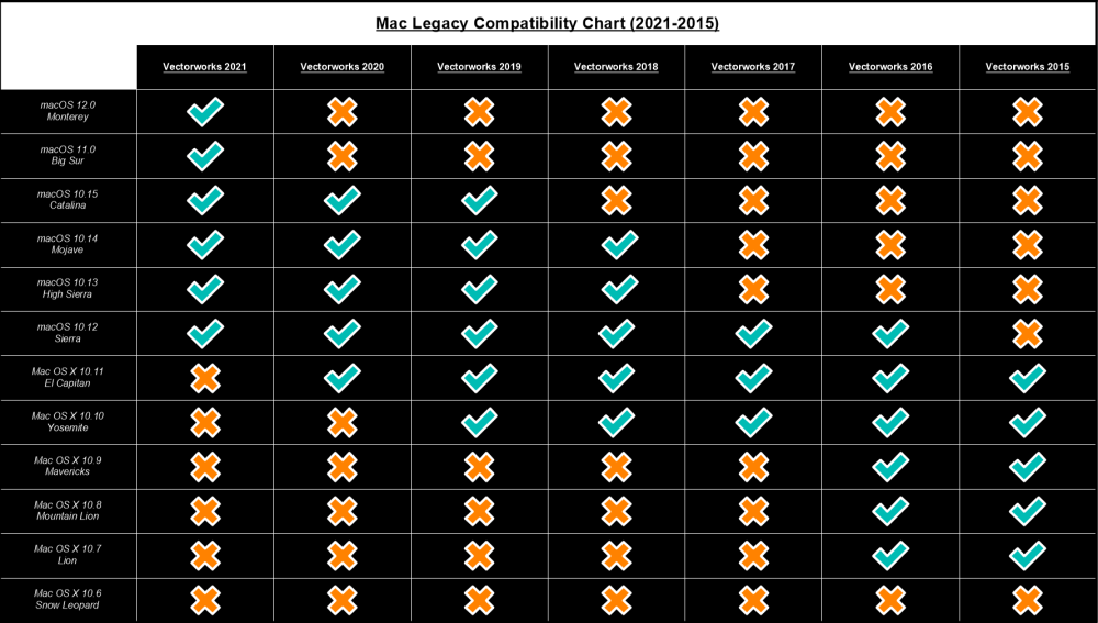

    macOS:

    I use an old version of Vectorworks 12.5 running on Mac OS 10.6.8, which I still use from time to time when working from home and useful in these Covid times. The iMac that I run it on is an 2.4GHz Intel Core Duo, and I am planning to upgrade the OS as the machine still works perfectly well. Does anyone know the latest operating system that VW12.5 will operate on on? I can upgrade the iMac as far as El Capitan.
    Any help gratefully recieved!
    S Dyson UK
    Link to comment
    Just for confirmation, I have looked at the legacy list that Vectorworks show on the website, but unfortunately it does not go back as far as version 12.5 which was the version preceding 2008. S Dyson
    Link to comment
    @S Dyson - even though the chart doesn’t go back as far as version 12.5, since version 2008 is shown as being only supported up to macOS 10.6, it’s safe to assume that would also be the case for version 12.5.
    Edited by rDesign
    Link to comment
