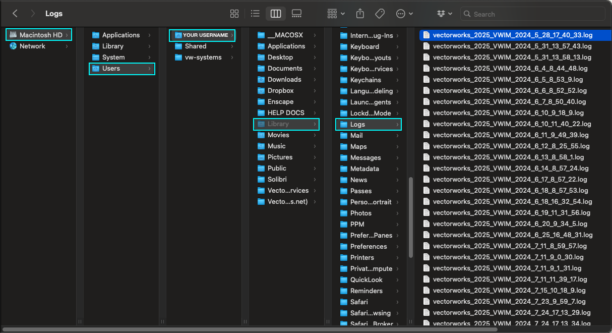

    MacOS:
    Open a Finder Window
    Navigate to Macintosh HD > Users > YOUR USERNAME > Library > Logs (or Press CMD + Shift + G and type ~/Library/Logs and press <return>)
    Look for filenames similar to: "vectorworks_2025_VWIM_2024_9_6_11_31_47.log" with desired date and time
    NOTE: On current versions of macOS, the Library folder for your User account is hidden by default. The easiest way to display it is to open Finder, then hold down the alt/option key on your keyboard while clicking "Go" from the menu bar, then selecting "Library"

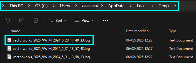

    Windows:
    Navigate to: C:\Users\YOUR USERNAME\AppData\Local\Temp
    Look for filenames similar to:  vectorworks_2025_VWIM_2024_9_6_11_31_47.log with desired date and time
    NOTE: The AppData folder may be hidden, so you will need to click on the View menu in the File Explorer window and enable "Show hidden Files" in the View Ribbon.
