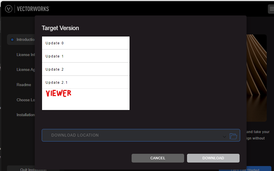

    Is there a way to do an offline silent installation of the viewer?
    This command will download the files from the internet
    • cli.bat install --installdir "C:\Program Files\Vectorworks 2025 Viewer" --serial "VIEWER
    For the full version you can use the Update0.vwim to do an offline installation, but for the Viewer, it is not possible to download a ".vwim"-File.
    I also didn´t find a possibility to download it via the Install Manager GUI.
    Would be nice to have a possibility to download something like a Viewer.vwim and use it for an offline silent installation of the Viewer.
    Using it like that: cli.bat install --installdir "C:\Program Files\Vectorworks 2025 Viewer" --serial "VIEWER -i "/tmp/vwim/Viewer.vwim"
    • Like 1
